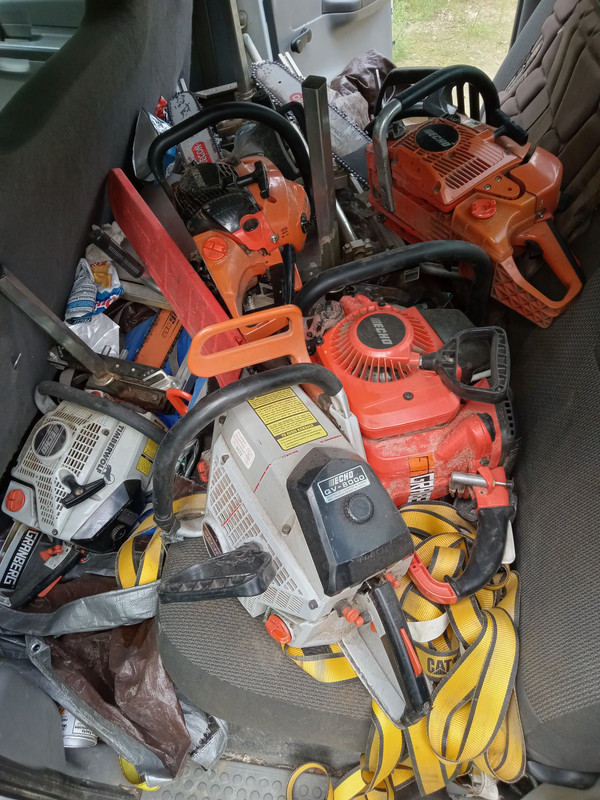

Soon as I unpack this fkn rats nest of grubby saws from my yukon river cutting/milling trip, gonna run a fresh loop of xcut against a clapped out loop of EXL. Will try it on a 620pw and a cs 8000 I ported.

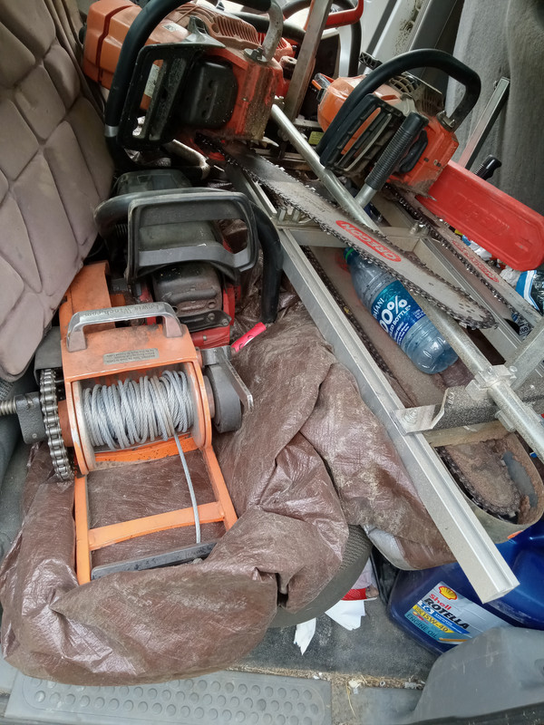

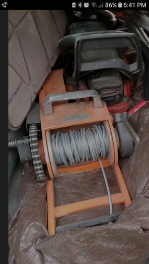

There was an older version lewis and a capstan on site. Both used for launching/retrieving fish wheels into the yukon for the now-defunct fall chum salmon run. Could've just left mine at home.
They had an old 066 mag for winching. Toe plate busted off the saw. Just like my 660 mag, toe plate had no reinforcement in the plastic.

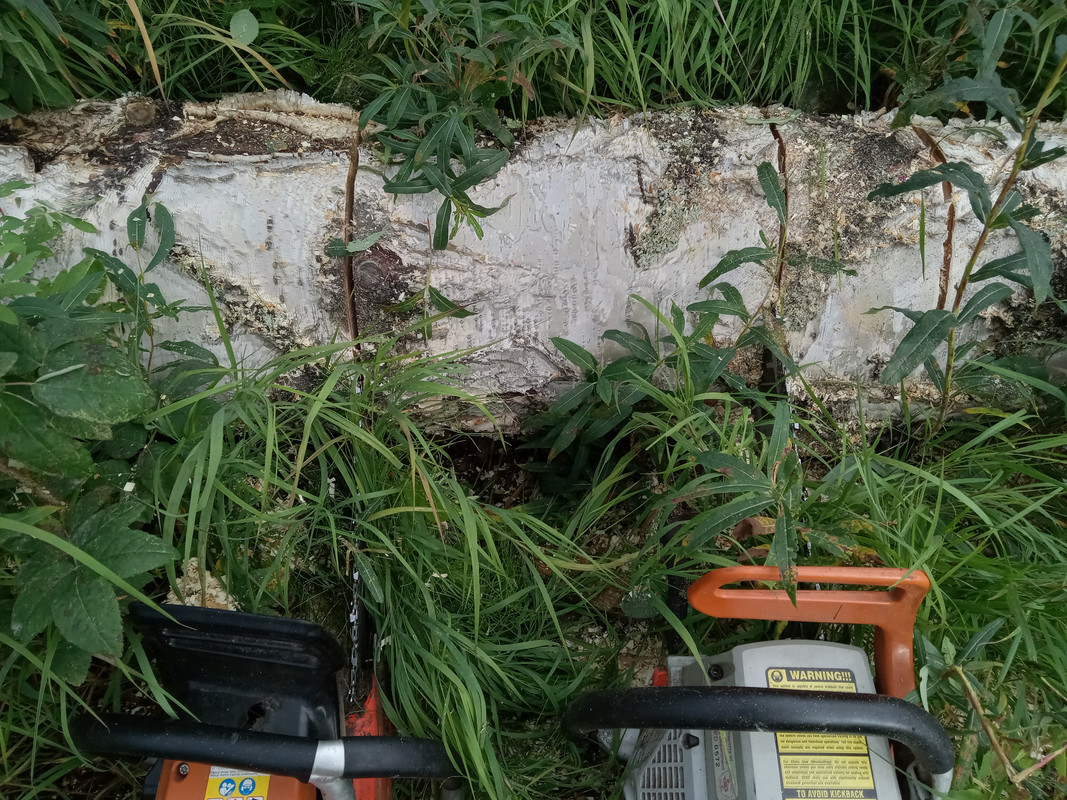

The EXL chain is cutting better than brand new out of the box the C83.
The xcut was all zippey zippey in softwood, but a large piece of semi-seasoned Alaskan birch, the kerf is too thin and it's pinching out in its own chips, mid-cut.
This c83 is on an 81 cc ported saw! I then grab the 620pw with EXL, and can cut right into the existing c83 kerf and it just mows through.
I'll try hand filing that dumb a s s beak off the tooth and maybe it will pull better, I dunno.
Right now, the EXL is the better, "all around chain".
U can see the kerf difference. EXL on left:

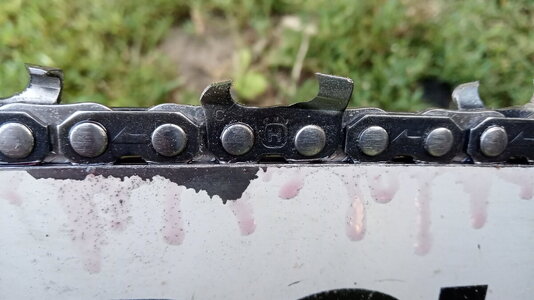

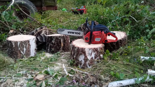

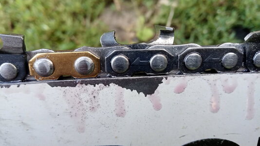

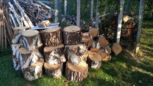

I love Oregon LGX & EXL, but I also really like Husqvarna X-Cut.
Bar fully buried in the trunk section, stock 56cc Dolmar PS-550, round ground X-Cut chain, fresh birch - it cut great.
