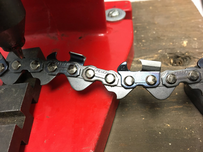

I can attest to this. April '21 I found a smokin deal on craigslist, I think it was 10 loops of 32" LGX for $100. Several loops had drive links that looked like this:
Emailed Oregon and within 2 weeks they sent me 4 brand new in the box loops of EXL to replace it, no further questions asked, and didn't want the old stuff returned.
I have since used the EXL a bunch and it's been fine IME. Even milling. Yes, [all]chain stretches initially... :buenrollo:

I had this happen for the first time a couple weeks ago. Was sawing up a big old horse chestnut that a friend had taken down. Was a yard tree in the city and I het metal twice. The one loop I was noodling with had 5-6 rakers that the file skated on. I had to apply a lot of pressure to remove that hardened material, then the file cut in fine.
I’d run those rounded loops no problem.

I inquired if it was a manufacturing defect, they simply said they'd replace it. I ended up spinning them in 16" loops and they are fine.

IIRC, those rounded Oregon DL's were supposed to "anchor" the chain better in the bars groove, help make straighter cuts - or something like that.
I think oiling was a concern by customers and the feature didn't take root.
I'd use such a chain the way it is no questions asked!
