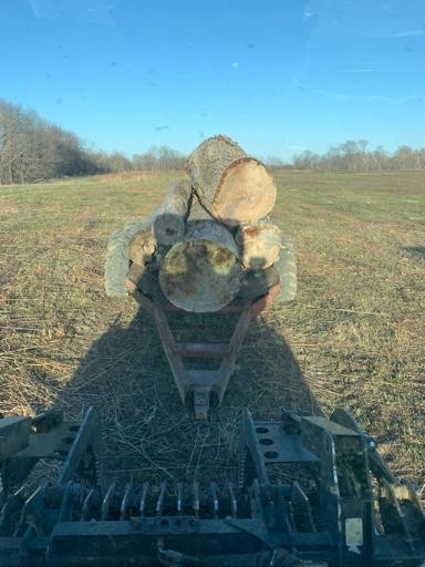

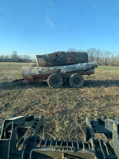

Brother and I put this together to haul logs
Old honey wagon frame
Sent from Hoskey hilltop
