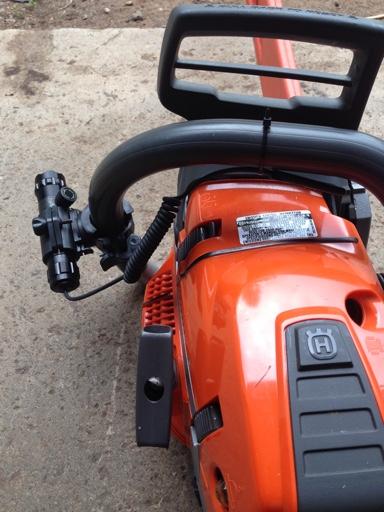

Time for an update. I’ve cut about 8 cord using it.
Short story. I like it!
The good.
The handle mounted switch is great. Cut a block. Squeeze the switch. Spot appears. Let go and cut. 8 cord so far on the battery with no fading or charging. And no laser flashing all over all the time.
The spot is visible in daylight on any log. (even 50’ away:) )
The delay to measure length is negligible. Something but nothing. And my blocks are very consistent.
The not so good.
The laser should be inside the handle.I bang it with my leg from time to time. Then my blocks are short. See calibration below.
The tilting torch mount was crap. The pivot was too loose so it would tilt whenever it wanted.
I bought a different torch mount that used rubber bands to attach. Easier to install and remove,but the rubber bands stretched and allowed for minor changes in angle. Minor angle changes result in significant length changes. I went back to the original torch mount and fixed the sloppy pivot by setting the angle then fusing the plastic together.
The cheap pressure switch had no strain relief so the wires broke. I repaired it and added strain relief.
Process.

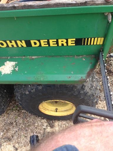

Calibration. Before each session,or if i think the angle is off I place the saw tip in a corner and check the dot is between two marks on the gator fender. 15”-16”. Easy enough to adjust, and the original torch holder mounts firmly enough it does not move without help.
Cutting.

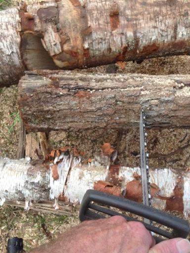

Moving right. Place saw tip at log at approx length and press switch. Move right until dot appears on log then stop. Or if dot is already on log, move saw left until dot is at edge of log. Let go switch and Cut. Repeat.
Moving left. Finish cut and withdraw bar until tip at edge of log. Hit switch and eyeball spot on log. Let go switch and cut at spot where dot was.
In both cases, you are using the tip of the bar to set the length. Important the chain has stopped moving in case it actually touches the log to avoid kickback.
End result.
It takes a fraction of a second longer to measure each cut. My blocks are now +/- 1” (except the last piece) whereas I was typically +/-4” eyeballing. It is here to stay.
Eventually I will make my own mount that locates the laser inside the handle.

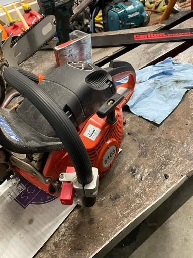

I've had this thing a while but just got around to trying it out and doing a review.
First off, it does what it says it does. Projects a small red laser onto the log. It was a sunny day and I coul still see the laser. It does take some getting used to.
Now the things I didn't like. The charging port is covered by a small rubber plug that could easily be lost. I mounted it one day after work to get it set up so I could start cutting the next day when I got home. I set it for 20" ony Husqvarna 545. I went to put it back in the power of case and it wouldn't fit with the laser mounted. It was a little aggregating to mount. It wouldn't clamp on the handle bar without used the supplied rubber strip. The Allen screws are a little hard to get to while holding it in position. It should have a toolless clamp. It also needs some sort of pivot so you can mount it higher on the bar and point it downward. It's close to the oil filler cap. It also needs a tethered plug for the USB port. It did get it my way while limbing the small tree that I cut. If I think of anything else I will add it later. All in all it's a good tool but could use some improvement.

I mounted mine with the laser on the outside. If I would have done it like you did, my saw would probably fit back in the case. I'll try it again. Boy do I feel like a dummy. I didn't look at any of the directions.
