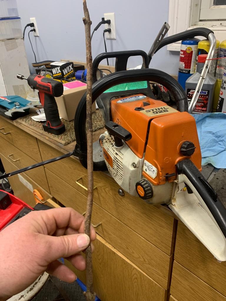

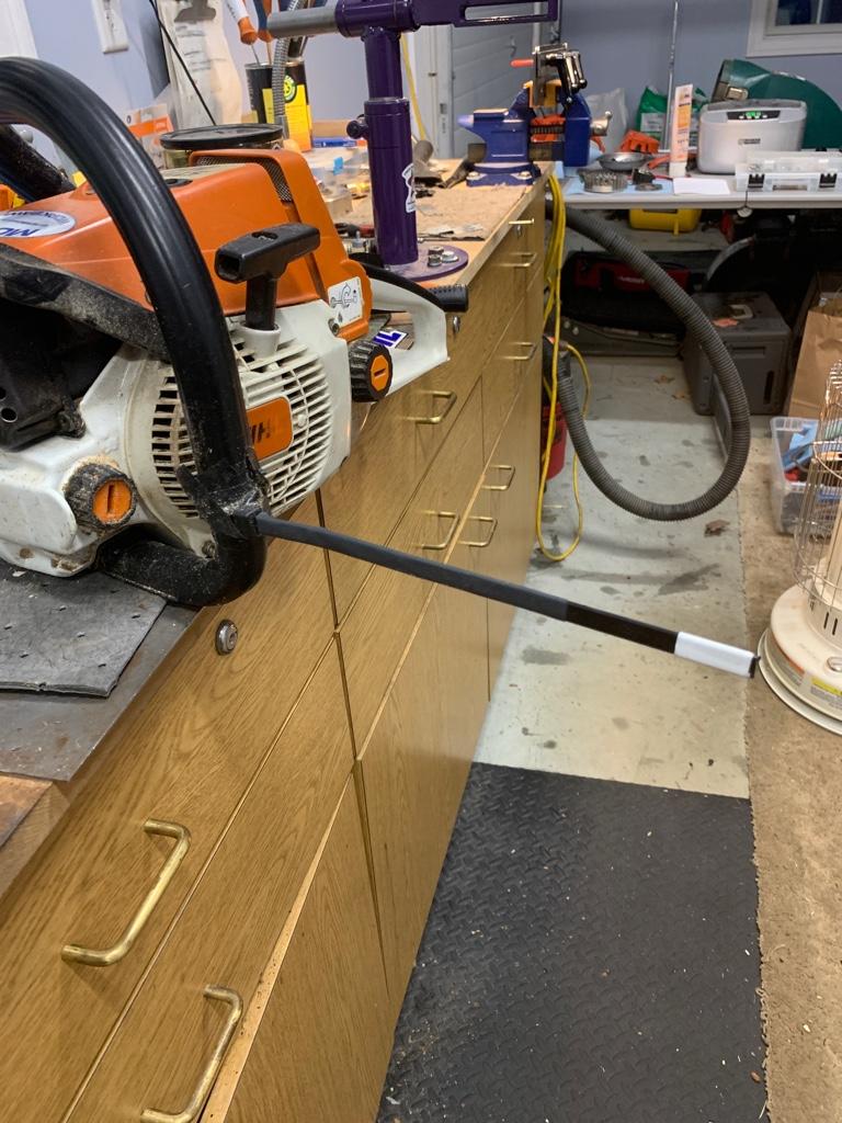

View attachment 270191 View attachment 270192
This is the only gizmo that turns me on lately. We have the Mingo and it works great most of the time. The paint cans have frozen or stuck open. I have the magnet sticks where I have made ticks all the way down the log and put it in my back pocket (falls out) or hoodie pocket (falls out), when I start to buck. Lately, I hold a stick over the handlebar under my hand or I bite it between cuts lol. The wood has to be darn close to 16 for most of my customers. Many times I have the luxury of holding the log with an excavator with a thumb. So it's grab, buck, get in and grab another log if I'm alone. What I like about it is when it's in your way or you don't need it for a bit, it just swings to the side. So if I'm cutting in a log pile it's still attached but out of the way.
This is called the Jober Teflon Measuring Rod. Supposedly is a Husqvarna part # but not available in the U.S.?
Husqvarna part number 531 3089 31
Cutters Choice website says no longer available also. I even called Timmerman's in Canada and they are sold out, due to the video I'm sure lol. I'm gonna make a couple this weekend.

I like this one a lot! I first saw it a month or so ago, watching Andrew use it on his Easton made channel. Great fellow, BTW.
Been looking for one since noticing it. I like that it simply folds out of the way when not in use.

Got this simple idea from a buddy: Get a small piece of trim wood and cut it to desired length. Walk down the log with a piece of playground chalk and mark it off as you go. Keep one in each truck, one on the quad. And if you lose one, just make another.
I think most guys are pretty good at cutting to their usual length without any gizmo like that. On the 16" I've been cutting for 30 years, I'm really close without marking. But when trying to cut to a different length than usual, most guys will drift back towards what they are used to.
I've been doing this for years now. Keeps it simple.

A lot of cool ways to measure firewood. I used to use the stick method. Had one for years with a little red paint on each end.
Then mark with lumber crayon, chalk, top handle saw, or what have you.
I'm liking the Jober deal for I can keep it on a dedicated firewood saw. I can grab my saw out of my shop, with gas & oil, walk down to the other side of my yard and start cuttin. Less stuff to carry around or leave behind. I've yet to dedicate one saw to this task though. Will be using something around 70cc and a 24'' bar though.....
I definitely want to keep my work saws out of the mix unless I need something bigger than 24" B&C. Then, I'll pick up the stick again.

Jober is dead...I was actually able to find a company that made it for Husqvarna and they’re no longer in existence. I put a zip tie with a piece of solder shrink wrapped on my handle works mint when holding logs up with a machine. Other than that I use a stick and hold it in my mouth between cuts. I try to switch species for a different tastes. Lol.

Another neat idea with the zippies. Dedicates a saw for sure. I wouldn't want to have to deal with that aloft in a tree ....LOL.
I don't have a saw for the wood pile only .....yet.
I'll try and fabricate the jobber myself. Just need some close up shots. I'll have to view Andrew's vid again and or reach out to him.
If I'm successful, I'll post my creation here.
