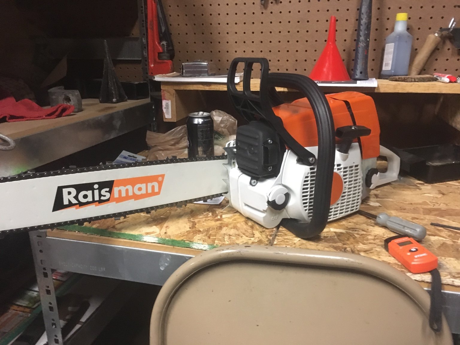

jackjcc
4:05 PM
1184
Apr 22, 2016
165
363
Minnesota
Some pics, couple of them are the issues I found, others overall and muff mod I put to it. Big difference in acceleration after muff mod.
It feels solid, the quality is acceptable, the cylinders are getting better as well as other parts. I need some opportunities to put run time on the saw. I got my first ported saw so I used up all my logs cutting with that!
