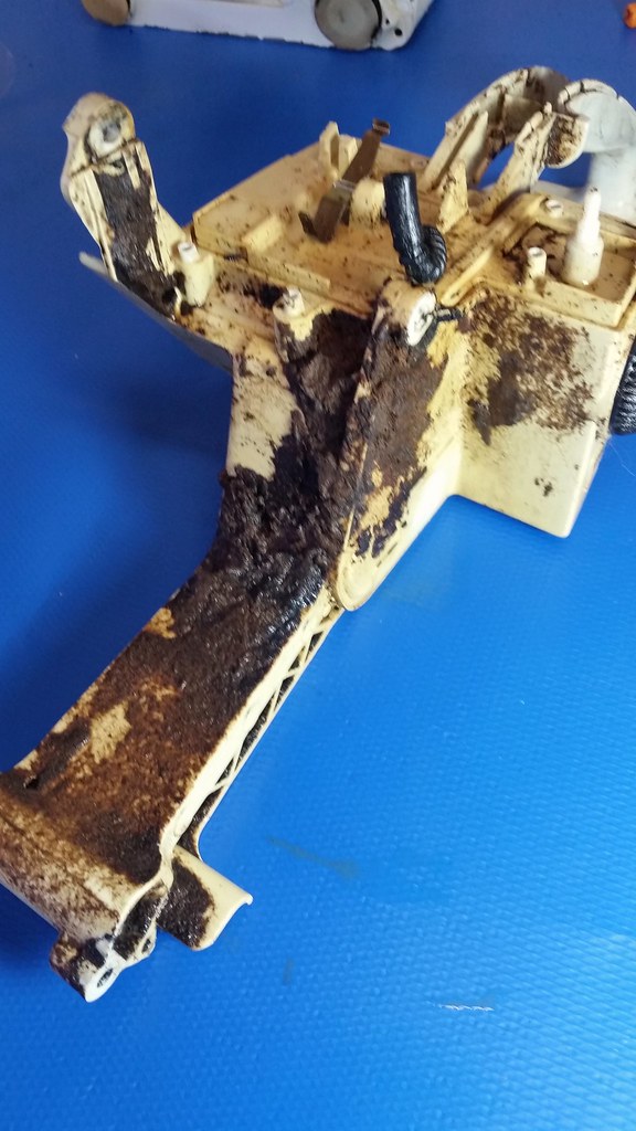

Tank cleaned up well too.

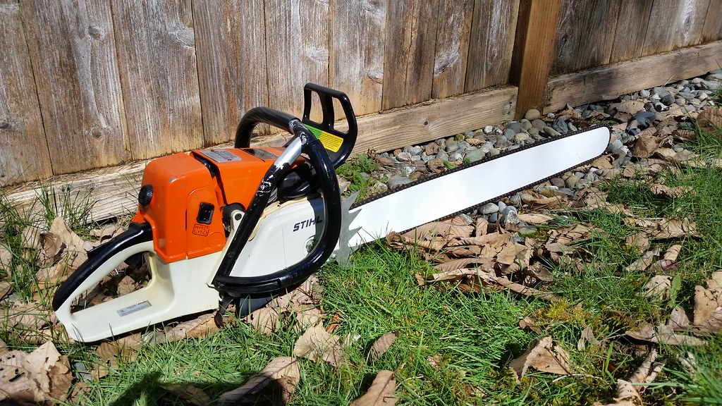

Well, I guess it was the tune. I pulled the carb apart again and cleaned/checked everything again. Put it all back together and it idles and runs great now! Steady idle in all positions.

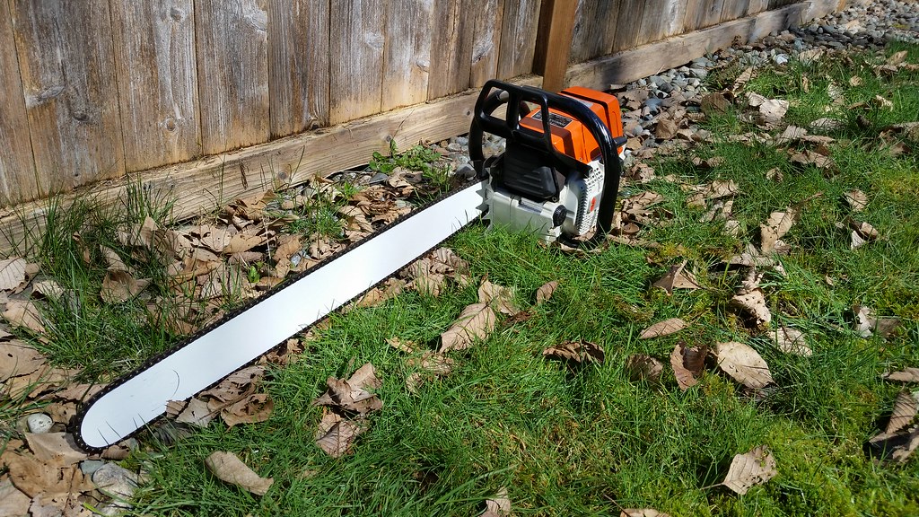

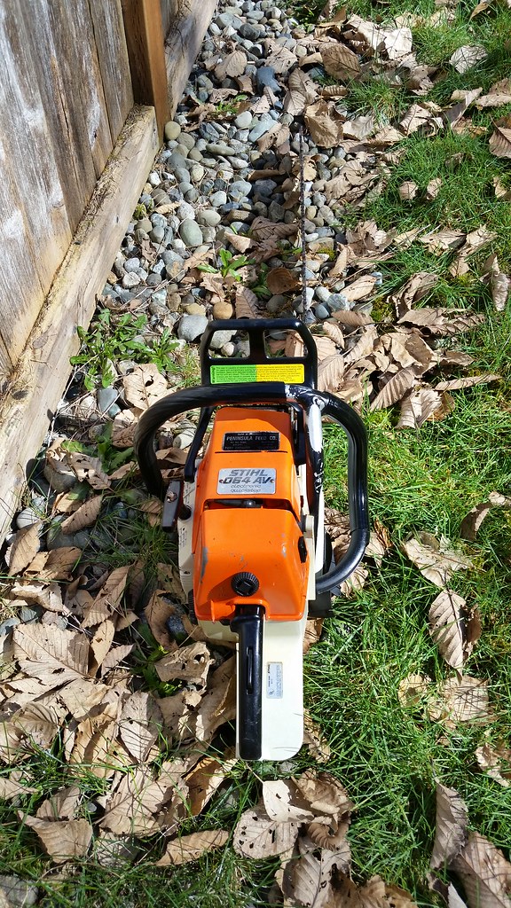

I went back to the seller the other day and picked up the bar and chain that I had passed on before. $60 with two almost new chains. It's a Stihl 32" bar that had been re-tipped and ground. Was missing all it's paint and had surface rust so I sanded and painted it up so it'll at least look good for now. I want to get a light bar eventually.
Jmssaws has some parts for me to swap to the new style air filter on the way but for now..
The new and improved three saw plan :)
Still need some smalls like cap seals and muffler flange so I can use the new muffler base. I'd like to find a recoil cover that is in good shape also.
So far I only have $275 into the saw/bar/chains.

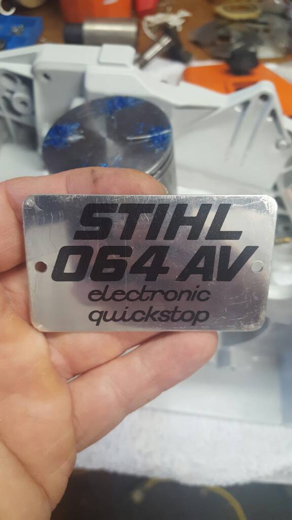

It is a nice saw! Im jealous of the 064 av plate on the top cover!! Lol! I want one on mine!!:D
What do you have on there now? I ran it by the label plate/photo etch dept at my work and they seem to think it would be easy to reproduce if they can get the font right.. If I get one made I'll make extras for ya'll.
