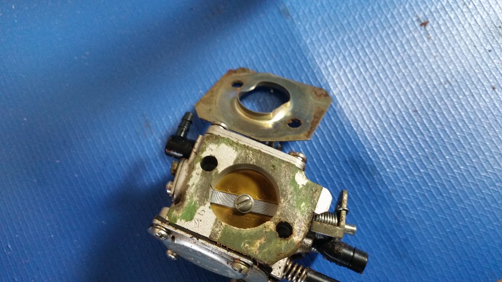

Here's mine, I fail to see any difference in how the carb mounts. Can anyone fill me in on this?
Boot came through the plate, then the metal "shim", then gasket, then carb.

The more I look at it, the more I think you could use either boot with either carb box as long as you have the correct shims/gaskets for the boot you're using. Correct? I only find one part number for the carb box which also makes me think they're interchangeable. Hopefully someone with more experience can chime in!

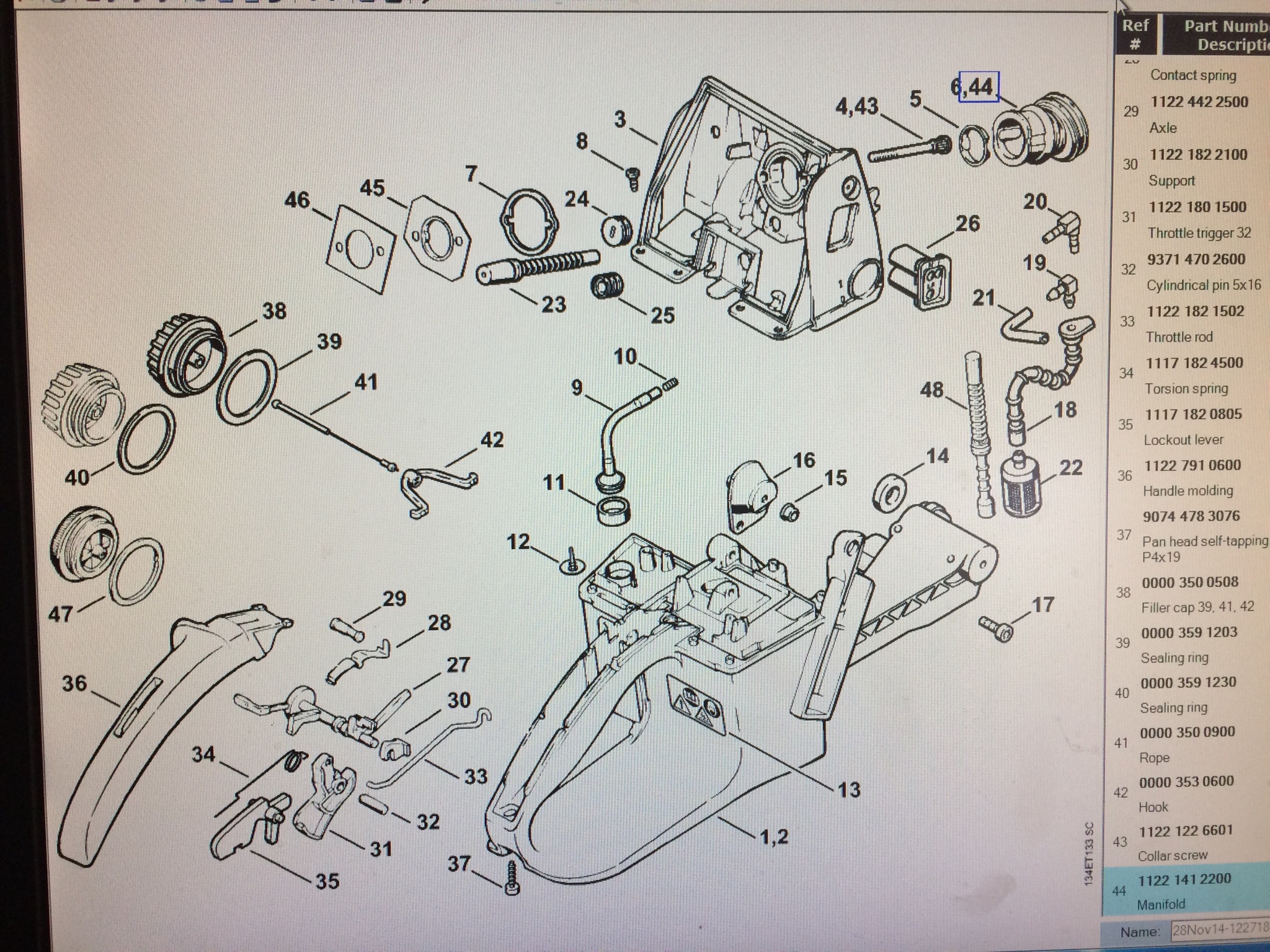

Here's the number I'm seeing in Parts Smart.

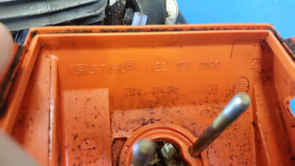

Still can't find for sure what the one I have is.....

Its not in the carb mounting, the difference is the intake boot and the thickness of it when it comes through the carb box. The one for that style that Randy has offered you is thinner. Randy is right, its in the thickness of the intake boot mounting hole in the carbboxes. If you switch intake boots with the wrong carb box you will get an air leak. The number of the early style carb box is 0100, the older is 0102, which to my knowledge is not written on the carb box. All you've got to do is remove your carb box and put this one on. Or get your dealer to order you the right boot. I'd personally switch carb boxes but its up to you.

The one I've got has got the 121 number, and the 066 ipl has the same number for it, 1122 120 0102. But mine came off an early non comp 066 so it will fit, what the difference is with the numbers I couldn't venture a guess. Intake boots are the same though.
