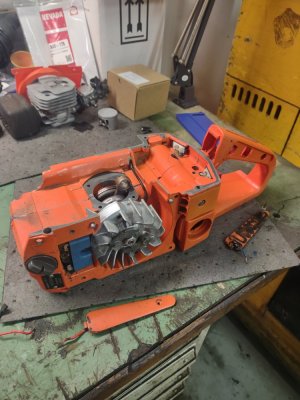

What is the 2mm spacer for?
Running the 238 cylinder with a 242 crank. The crank is 3mm longer. Will have better rod ratio. It will dwell a little longer on TDC and BDC.
Also because finding a 242XP top end is more or less impossible for a sensible price.

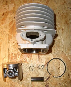

Okay, is it Golf from Turky or Api from India?
I tryed to welld a pop up piston from Aip, very dirty aluminium.
Asked the owner and he said he doesnt know. I'll see when it arrives.
