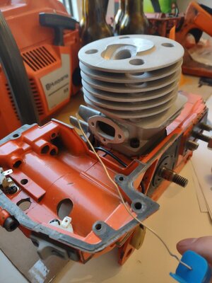

Golf is trash. Crooked wrist pin bores, shallow circlip notches, uneven skirts. No experience with Api. I would use Farmertec before Golf.
Hello. I havent find any farmertech cylinder, for the 242xp.
82f100swb
11:25 PM
2250
Dec 6, 2016
257
978
Dryden, ON, Canada
That round fin cylinder is branded and distributed by Brumar out of Italy. Who actually makes it is an unknown, Brumar seems to be a wholesaler who private labels stuff.
Apparently they are decent quality, and porting is comparable to stock from what I have been told by a couple people who have ran them.

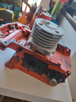

Did you reuse the old crankshaft bearings for this build?
Interesting looking cylinder - I wonder why they made it round?

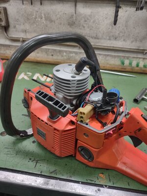

Exciting! Did you get timing numbers off the cylinder?
