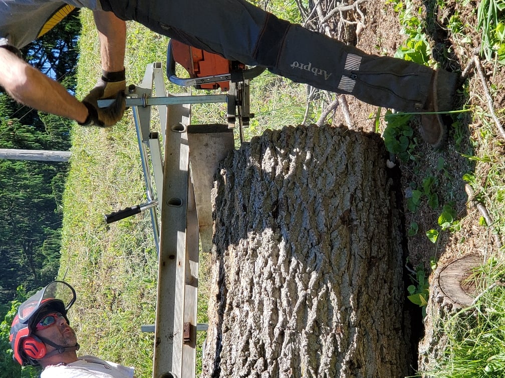

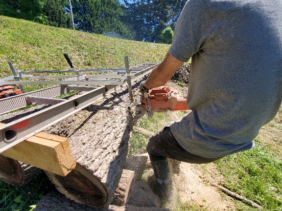

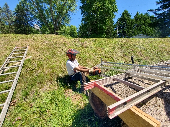

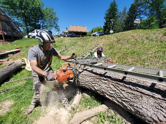

I have a 36" Granberg and with a 36" bar I can cut right around a 29" slab. I have run a 066 on it and has done quite well. I bought the Granberg winch system and it make milling easier. Many have made a winch for theirs. I did build an auxiliary oiler but have yet to use it. I feel it needs more oil than a saw can lay down. I do have the HO oiler on the 066. I have an aluminum ladder that I use for my first cut.

Like this...
