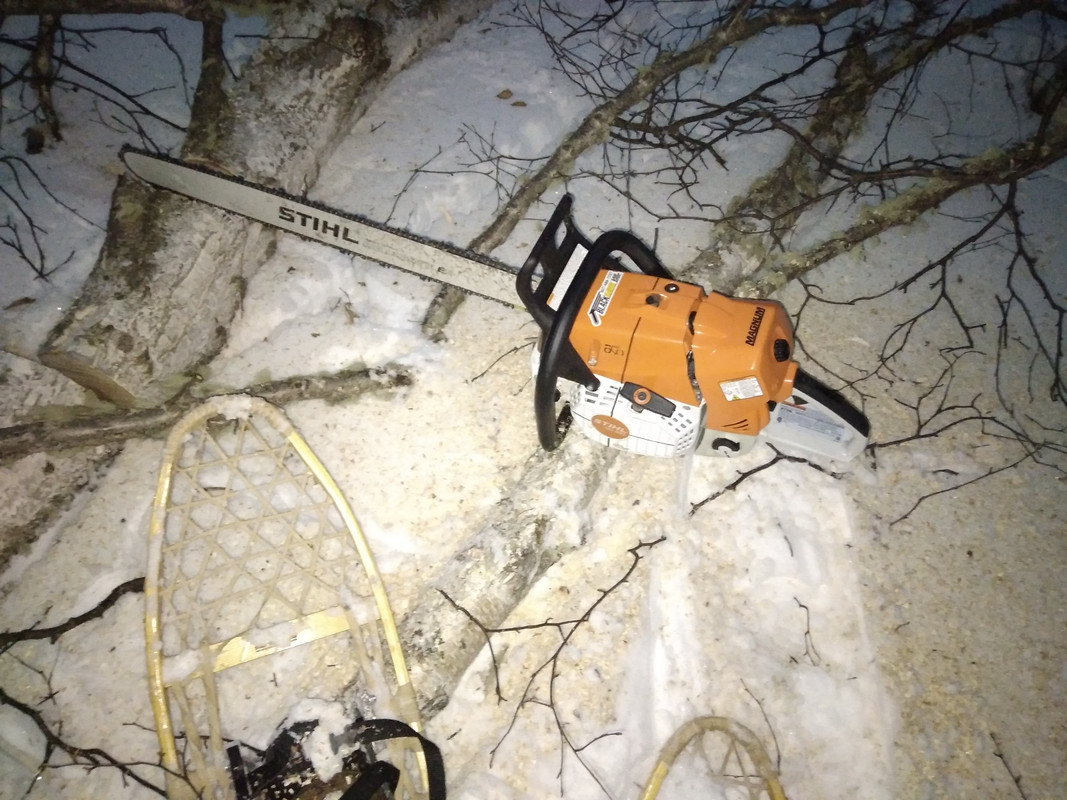

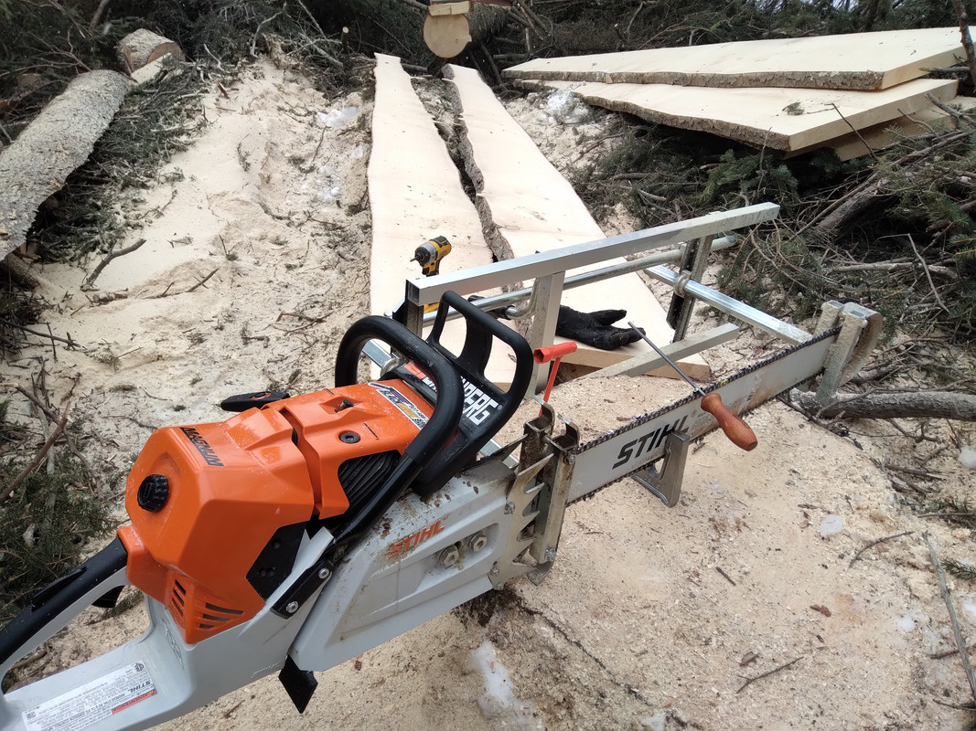

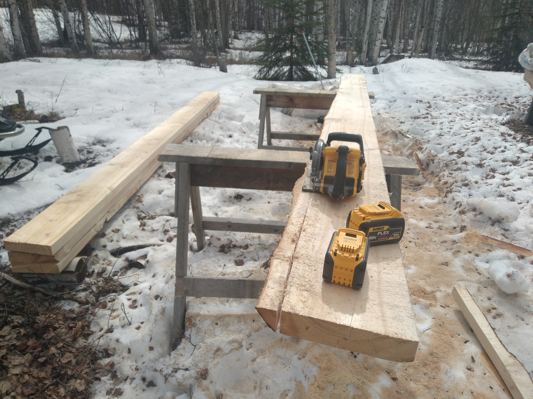

I prefer the chainsaw mill for the mobility in areas of challenging terrain or remote locations. The slabs can easily be moved with a small atv or snowmobile. Ive even hauled my saw mill and slabs with a dog team.
The finish is oustanding with the right chain. If you're in good shape and using good technique, you can put up $8-10 grand of lumber in a month.
Dont give a sht about kerf waste, as Alaskan birch and white spruce are all i mill here in Alaska, not high value wood. Big deal......a 1/4" of kerf loss. No biggie to run a nice birch slab through a plainer for a good finish either.
Alaskan mills and Lewis winches are must-have equipment out here in bush Alaska. Will probably never consider a band mill. None of the powerheads work in -20 below zero anyways, which is a common winter temp that I chainsaw mill in.
Theres an overweight, fair-weather trust-fund baby up the hill from me, who fires up a full hydraulic woodmizer in the summer. He likes his set-up.
Anyhow, i recommend 100+ cc saws. 3120, 880, 881. Or even the best milling saw ever made.......the Echo cs 1201.

Yep, throttle lock, and a superior oiler on the 1201.
881 has no throttle lock and a very stingy oiler. About 3 oz of oil per 16 ft long rip.
1201 has larger crank, and better low-end torque.
881, if you hit a rock-hard spruce knot and the chain be too aggressive, it falls flat on its face....bogs to zero rpms.
1201 runs cool, 881, being a stratofied saw, heats up after a 16 ft rip. Gotta high idle is for at least 1 minute, to cool it. Definitely have to run a smidgen rich on both the high and low jet.
BUT, the 881 is the easy button. Excellent filter, cleanest clutch cover ive ever seen, never builds up gunk. Can swap to softer 880 rubber av mounts, for when rubber turns hard as a rock in 20 below zero winter. I have two sets of rubber av mounts.
Its light enough that I even buck firewood for about 4 hours at a time, before it feels heavy, a nice narrow powerhead. Balances a 36" bar perfectly.
I have milled enough wood with the 881 to build a 36x40 2-story shop, and a 26x16 ft cabin. I know it well enough. I guestimate about 22 gallons of 40:1 mixed fuel through it with no mechanical issues.
I like that the high speed jet isnt fixed like on a 3120, Important to tune saw right for 20 below zero.
