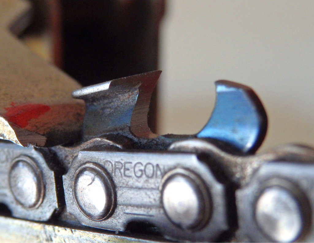

Here's one I did for a buddy of mine the other day. Before and after
Man your square grinding looks mean!!!!

You certainly have improved your round ground chain a lot since this thread began. I can't see how you could make it much better to be honest. Great job!
Here's one of my pictures of round ground on my Oregon 620 after I got it.
One tip I can offer with regard to taking pictures if you are using your phone is to get yourself one-of these:
This lens clips onto your phone and give you much better "macro"-(up close pictures).
They're pretty cheap too for a high quality Lens. Less than $30 on Amazon
Also,in addition to this lens if you have an iPhone the camera has a built in "magnifier" you can use to give you additional magnification that I find useful.
