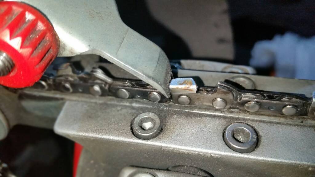

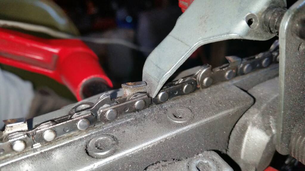

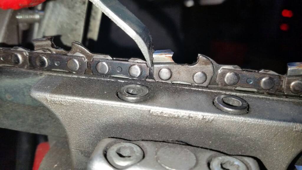

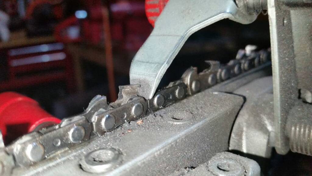

Well I found some metal boys...this is why I gladly keep the safety chain everyone says to throw away...I use these "throw aways" when I think I could get into something nasty, and boy did I........I assume it's galvanize or aluminum!!!
It's a Stihl RM 3/8 safety chain...pretty bad guys!!
Ok here she is all cleaned up with my new to me USG....I am liking her more each time I use her!!!IMG_2695.JPG

When I grind a safety chain, it leaves here a cutting chain.
Safety chain is only another word for " liability case"
Any chain can become a cutting chain.

How did the tie straps get ground into?

I don't remember if it was from me or the prior owner....it's a good chance it was me....I also use these "freebie" chains to do my experiment angles on.....

yes it will cut when correctly sharpened.....they may not be the best, but I will continue to keep all I can that are in good shape....they are good chains to try new angles on or use in dirty/harsh conditions....
