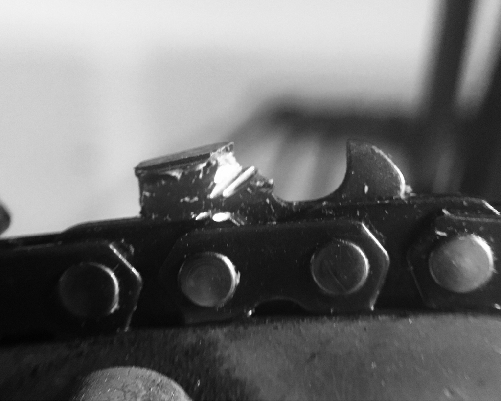

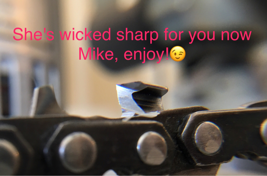

Ok guys I was gutting the baffle out of my 461 and doing a muf mod the other day....I ground my 25" RM chain while I was at it.....
After I ground the chain I decided to hand file one cutter, just to see how close I am keeping my grinding and filling profiles the same.....
I will post one picture of each cutter, can you guys tell which was hand filed and which was ground....
We can call the first picture A and the second picture B.....
Picture-A
Picture -B
I say that A = Hand filed

Oh and it must be an optical illusion because the cutters look like RS or chisel chain....I will assure you they are 100% RM (semi-chisel)....
Absolutely look like full chisel cutters to me.
The profile curve on 'B' looks smoother to me; 'A' looks more like several segments joined to form the curve. So I will guess that 'A' is filed and 'B' is ground (but that could vary with technique).
Philbert
EDIT: OK , just saw your answer on FaceBook.

Ok guys the picture A, I posted was sharpened with my grinder..
The picture B, I posted was handfiled....
You prefer hand filing or grinding?
The white stick you got with your wheels, have you used it yet?
I guessed A reading the previous page notification first. Hand filing would be much smoother imo because of imperceptible jumping by the grinder. But the machine is obviously used by someone who knows what they are doing. In most cases if someone was doing a lot of chains commercially the wheel would be banged down and show that on the bottom of the movement.

Also, that raker has been ground without using the tunnel part of the wheel and like you I have found...who cares...as long as the height has been reduced. Otherwise the raker wheels would have a big hollow ground in them and get tossed much quicker.
