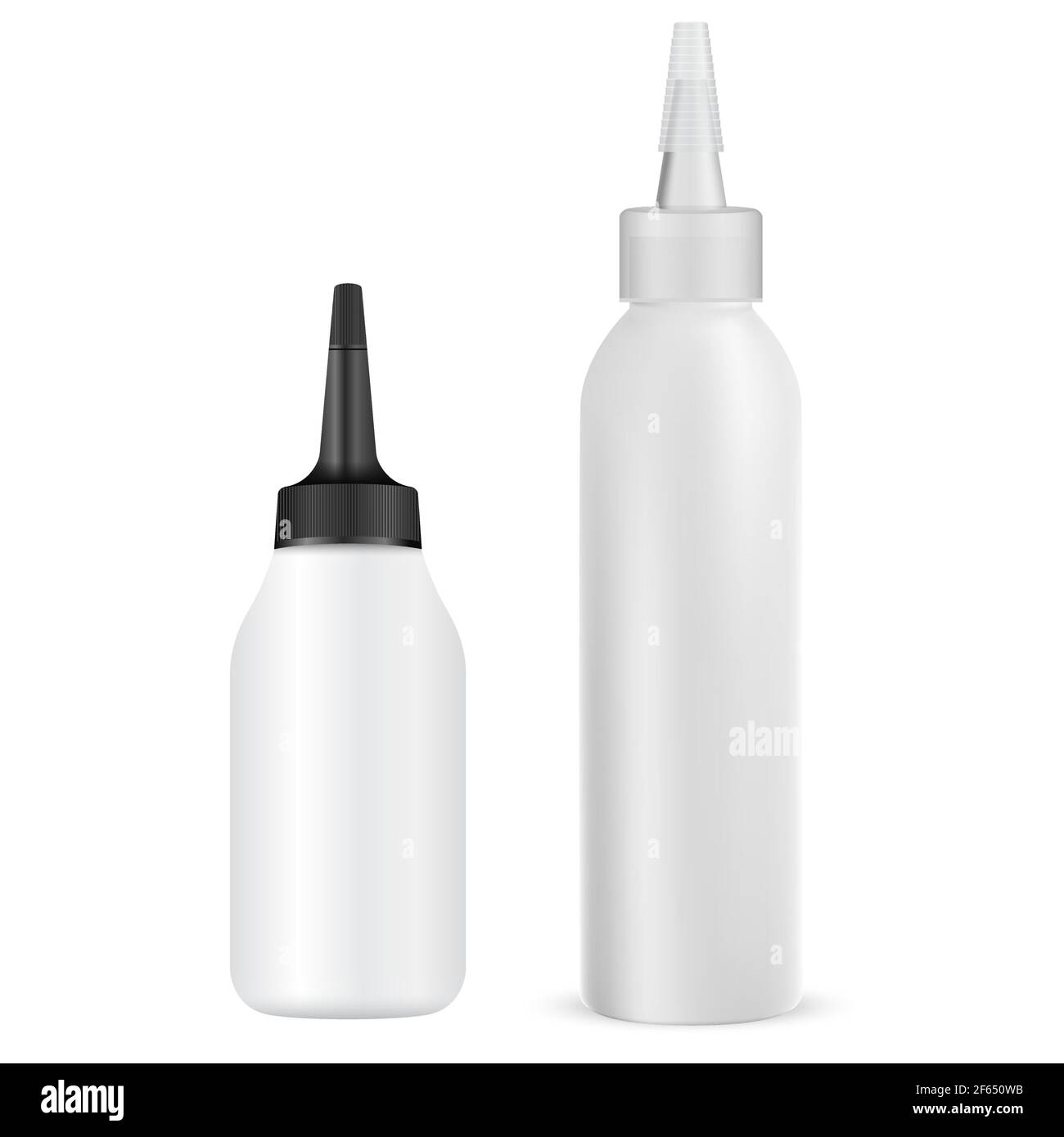

One of the issues I have with the ATF/Acetone mix is find a decent steel squirt bottle to put it in.
Easy peasy......just ask your sister/wife/neighbour/mistress for any spout bottle for hair colors (they get them in a kit)
Those with threded ends are the best!

I cannot even get a plastic spray bottle to withstand Picloram let alone acetone. That is why I use steel squirt cans but decent ones are hard to locate.
Those bottles above whitstand acetone.....my are staying filled with 50/50 mix for 2+ yrs...
Well you see sir.........
Never had a sister
Never had a daughter just three sons
Neighbors are cows
Never had a mistress
Wife is long gone
I have no hair to color, Tried coloring my beard years ago .....epic failure
Neighbors are cows
Try this then....
