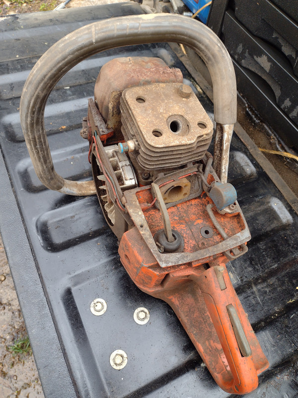

Freebie 288
Good crank and topend and has fire
No idea why somebody stripped it down
It'll get a china clutch and plastics, recoil top cover,brake flag
and intake I have a tillotson for it.
