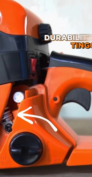

Unsure if this has been posted before, there is a sort of remake, not quite clone of the Stihl 070 AV, with a chain brake.
I also found a video showing a version of the generic Zenoa clone, with twin vertical anti-vibration springs between the carburator compartment and the gas tank, YSK 12000XT 26L.

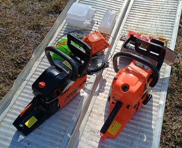

image.jpgRan that today. Things went well. Started fast after sitting for probably over a year. Tube was close enough. Two tank full. 24” pine and 24+ “ dead oak. Chain needs a touch up and honestly needed one before I got in the woods. Had to dog in a little to get saw to clean up. (Running too rich)
Pinched the saw pretty bad in the pine. It was blown down and didn’t want to fall on the ground
Stump was also trying to stand back up. Even after tugging a little to free saw (didn’t work)
Everything feels completely normal so decent build. Runs great. Would own another. Fuel lines have withstood ethanol fine. Just an update.

Thanks for the update. Does it leak all the bar oil out like mine?

😂 I don’t know. If it does it takes a bit. Some of my other saws leak so it would be hard to notice. They all sit in a general area in the shop and it’s pretty greasy over there. I left the saw out of fuel so bar tank shouldn’t have had much in it. There was a tiny bit of oil still in the tank.
