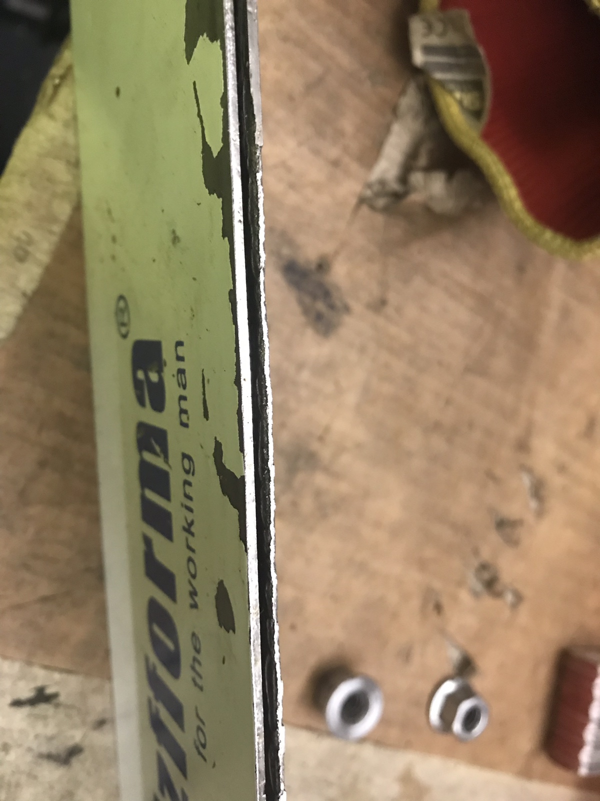

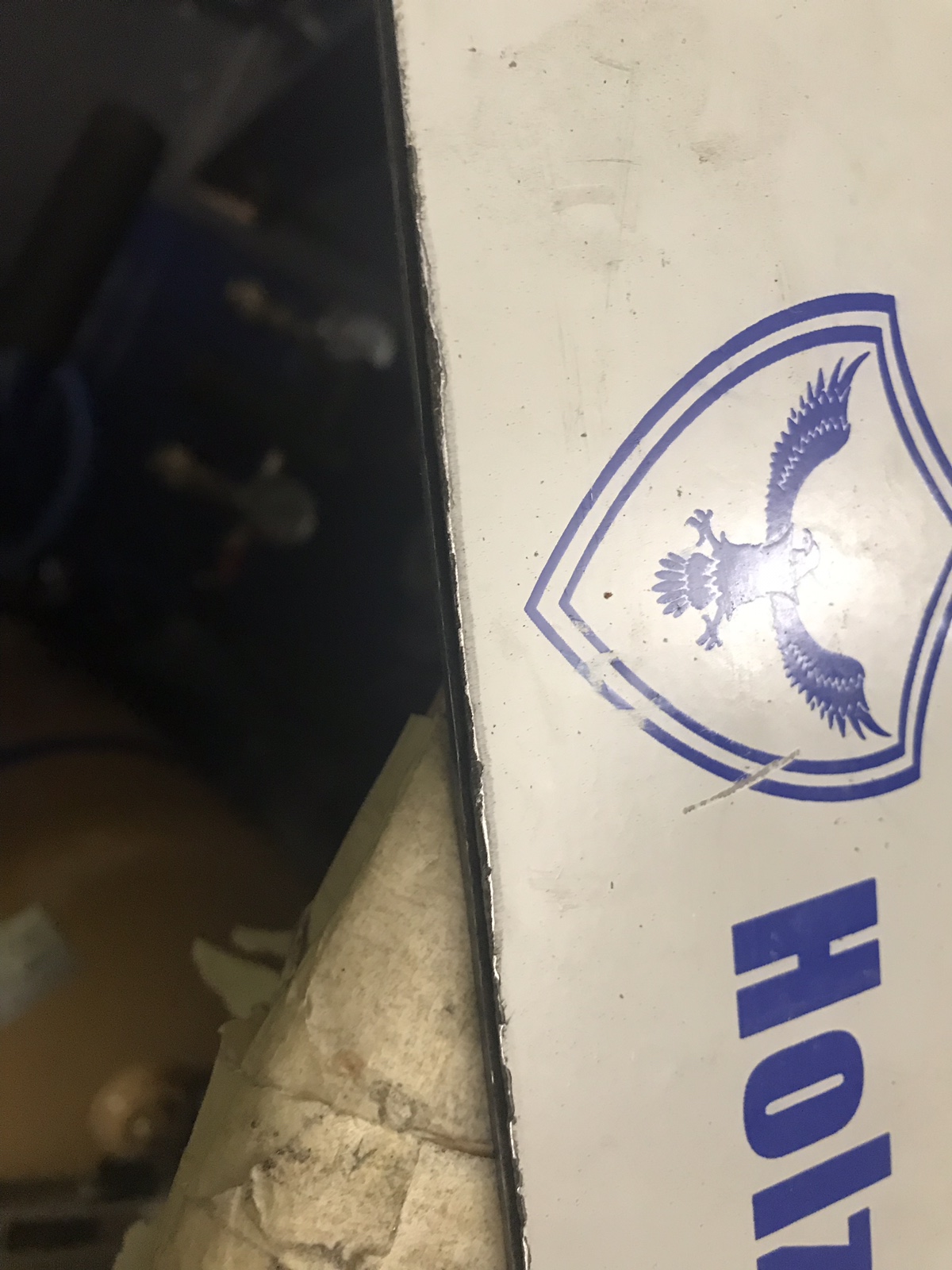

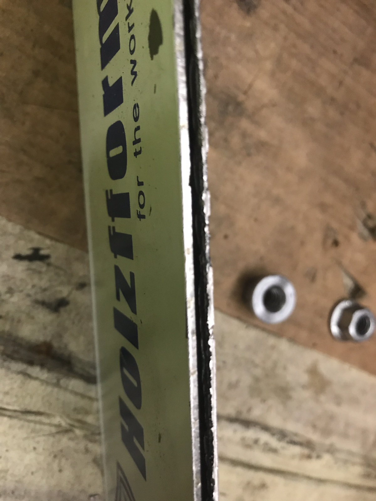

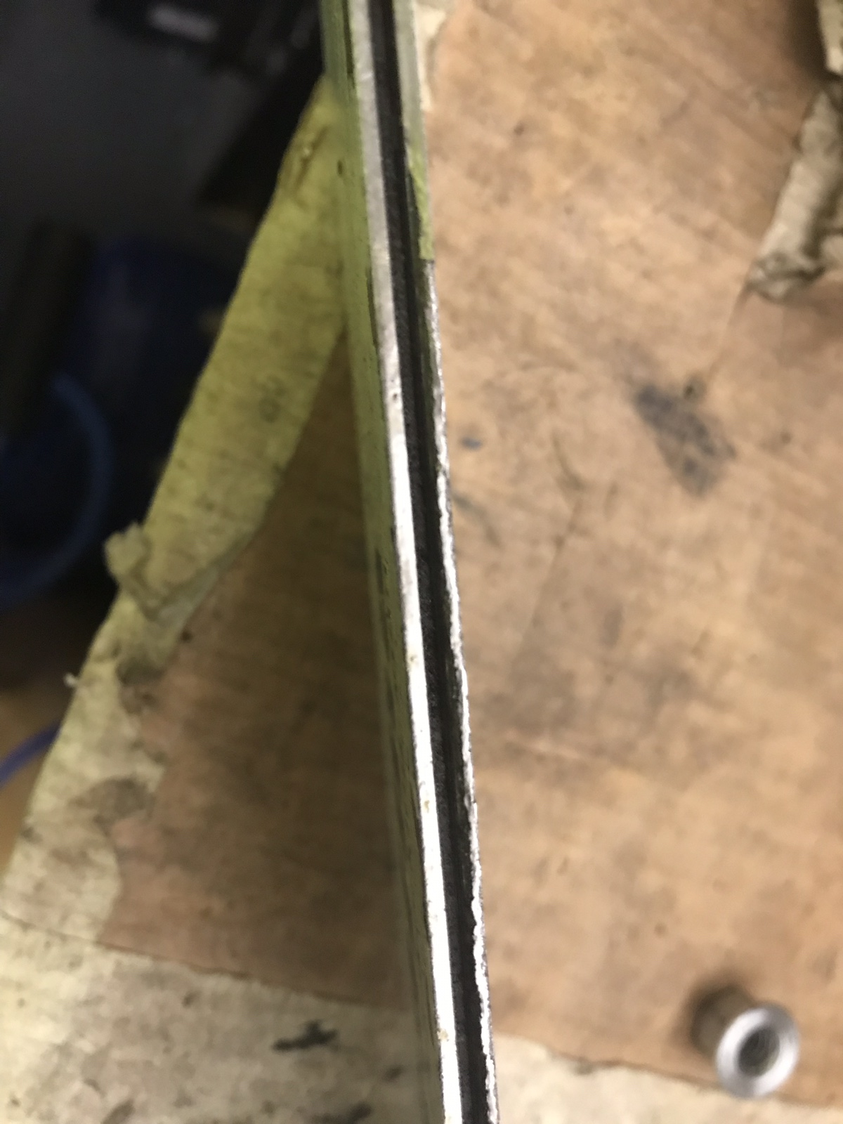

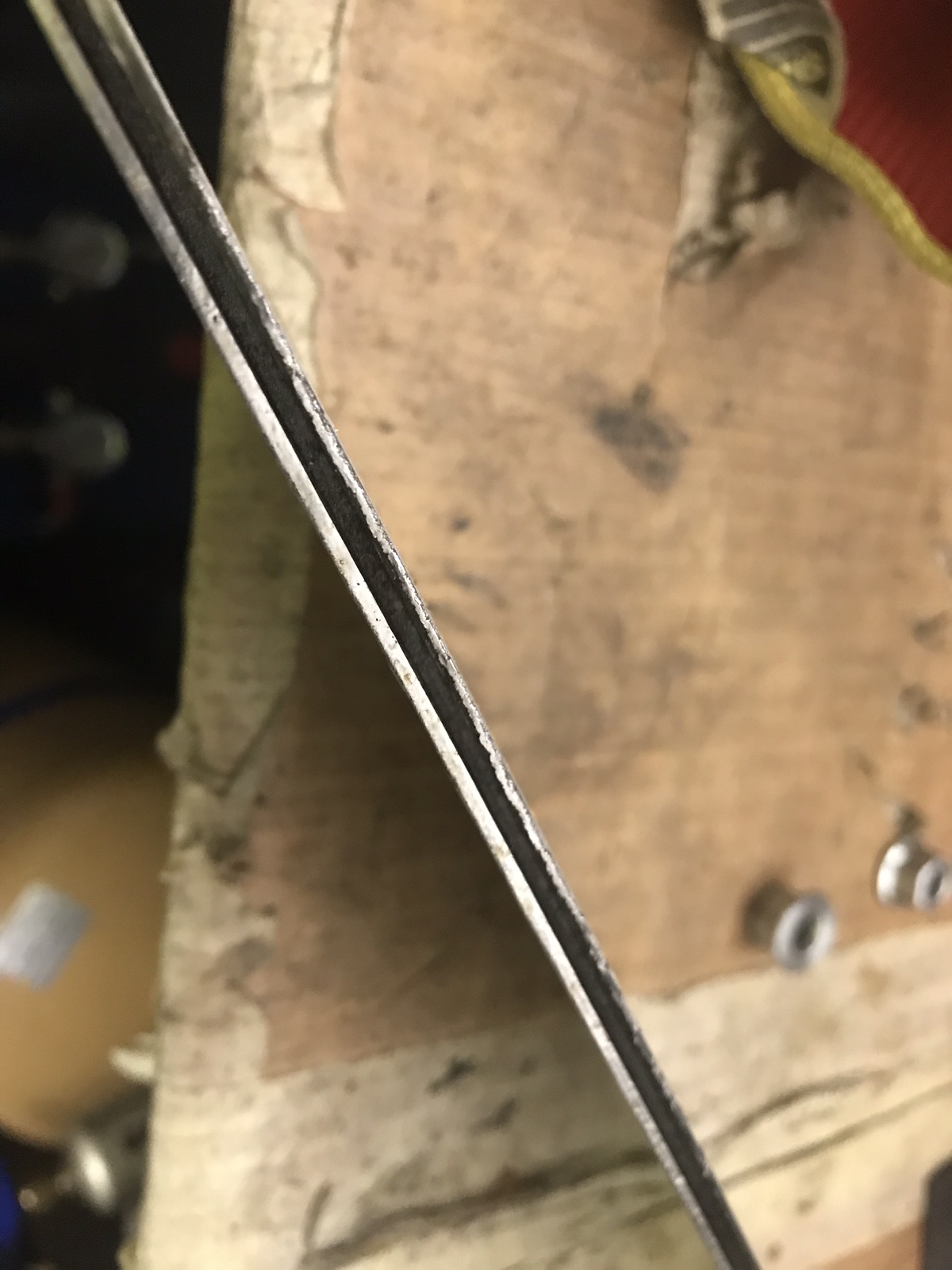

Some bar issue. Do you have any idea what happened? Always enough oil available. Can I continue to use it?
Appears to be poor quality heat treatment.
The edge will likely chip off.
They've been good about returning bad parts here.
Don't know about Germany though.
Are better quality bar's available there?
Tsumura sugihara Oregon cannon.
And of course you can use an adaptor
To use stihl bar's.

That is one crappy bar, I'd ditch it and get a decent bar. Nothing expensive, unless you want a lightweight bar, but something that will hold up.

Sure there are bars available. Maybe i'll take the original Husky bar.
I've got over a dozen husky branded oregon bar's
They've been good.
