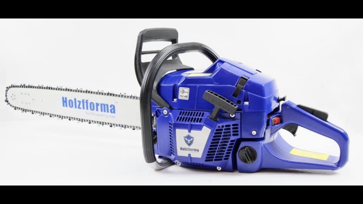

You mean this one?
9:57 AM
34,537
196,713
You mean this one?

Time for a feedback! :)
I used the new baby to cut two small trailers of firewood at my home in a sawhorse where i can put around 8 1m pieces to cut them to the length i need in my oven.
The 50cm bar works perfect because a shorter bar won't work in this thing.
I'm using this sawhorse: https://vdxl.im/8718475899204_a_en_r458.jpg
The G372 is running well. I'm fighting a bit with the carb settings...but it has a lot of power. Will have to exchange the fuel filter i think. It's to light and "swimming" in the gas. Therefore i can't get the tank emptied completely. I also feel that the AM airfilter which comes with the saw is "limited"...
The Holzfforma chain is also good quality i think. Stays sharp a long time. Maybe i'll remove the decompression valve because i think it's not completely tight.
Concerning the oil-topic i had...what should i say. NOTHING. NO issue. I used the saw yesterday. Cleaned it only from the outside with compressed air because i'll use it tomorrow again. Didn't remove the bar or anything else. Put the saw to shelf in the garage. NO oil coming out...really nice!
I hope the G372 and I will be friends for a long time.
Up to now i don't regret of buying it. Just put a BB on it where i opened the ports a bit and cleaned out the intake and outlet. No gasket. Thats all. The saw accelerates like hell. :D

That's good
it's working out for you
Do you mean you need a heavy filter to keep
The filter where the fuel is?
When it's moving around the tank
Post some pics of what you're cutting when you get a chance.
