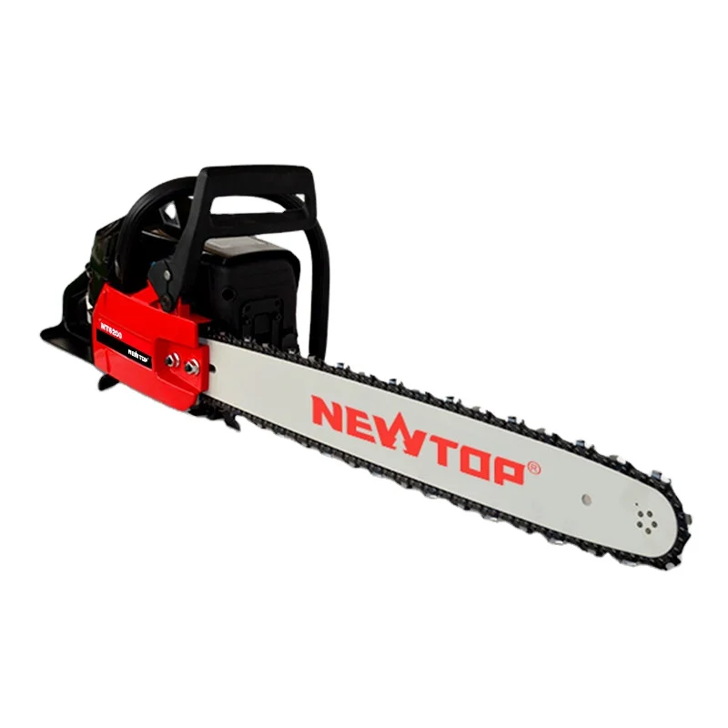

That company's web page is crazy , reminds me of pictures Walmart had 25yrs ago! Happy faces!
They must be doing something right they've been in business over 20 year's making
All kinds of saws i know they make 61/262/268/272/660/070s
They may make the 288s and 395s just guessing because the g272 hardware and build quality looks very much like the g288 and g395
Another big company is EMAS I never was able to buy any of their saws either.
I want one of these hus262s i think they might be very successful here.Screenshot_2024-02-14-10-00-30-740.jpgCraftop-Professional-Chainsaw-6200.jpg
