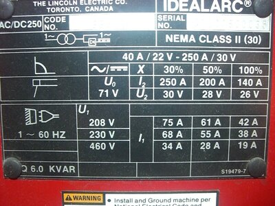

Welding is different. If it were a range/stove absolutely. With welding all things come into consideration. In my situation coming out of the breaker box is 6AWG, the weakest link. But it's only 3 feet in length, and a 50% duty cycle should allow a temporary/small overload. At least that's how I understand it all. May only be academic, as I burned 1/8 rod at 70amps the other day. This machine feels like it will run a 1/4 rod, were I to weld a steel bridge. Not likely.
For my own reference (off back of MY machine) :
Input @Breaker
(plate on the back)
Output @Electrode
Dial Setting
%Duty Cycle
38Amps140Amps (1)100%
55Amps (2)200Amps50%
68Amps (3)250Amps30%
(1) Max so far 70Amps, 1/8" rod, 6011
(2) Swap garage breaker with 60Amp
(3) Probably just leave it all alone. (i.e. Don't Use!!!)
If things are linear or close enough, then at the dial 70Amps, I am only taxing my electrical set up at maybe at 1/3 capacity. :thumbsup:
On MY machine ->

Welding is different. If it were a range/stove absolutely. With welding all things come into consideration. In my situation coming out of the breaker box is 6AWG, the weakest link. But it's only 2 feet in length, and a 30% duty cycle should allow a small overload. At least that's how I understand it all. May only be academic, as I burned 1/8 rod at 70amps the other day. This machine feels like it will run a 1/4 rod, were I to weld a bridge. Not likely. That 60amp breaker is going to get returned. Not needed!
You can weld any thickness metal with 1/8-5/32” rod just takes longer. Big rod doesn’t increase welding capacity In fact most tests and job procedures will specify no larger than 5/32” rod on even big welds. Did a 24” deep beam with 2” thick flanges and a 1” web, the procedure was preheat to 300 and weld with 1/8” or 5/32” 7018 max. Small rods allow for better control
