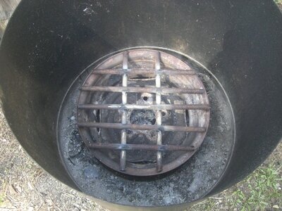

New welder is amazing. Easily strikes an arc at my cheat sheets lowest setting.
Got to spend some good welding time cutting and welding a new grate to allow air to more easily flow from beneath the wood in my smoker.

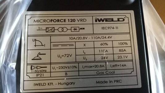

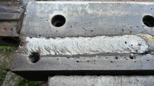

Last week I added this tiny machine to my shop inventory, officially rated for up to 110Amps and 2.5mm electrodes.
After some minor tinkering with its setup features from default/off to higher/on it melts 3.25mm Basic coated 30+ year old Oerlikon Spezial sticks into a deep wide bead.
This is now the hottest welder in my household/shop and it runs on any outlet I plug it into (so far!).
