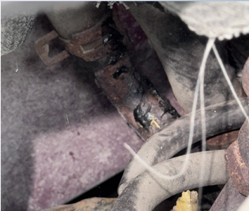

It is hard to find welding work, even when offering the work for FREE. Lots of people either can't read or have problems understanding (illiteracy?) that I am NOT giving away free welders.
I got this gem from a guy looking for, what apparently is a miracle. Wants me to "weld" this part in his Suburban. Can't weld rust, I told him. He's probably devastated or thinks I'm incompetent or too lazy to even try. :D

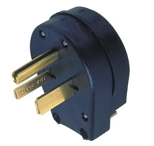

Is this a limiting factor? 50 amp welding plug 6-50p. What is the next step-up plug for Amps greater then 50?

As far as the plugs I've usually used range plugs which I think are 50-60 amps .However they do make plugs that are over100 amps but my word if you have to buy them they are like the national dept .Those are locking types used in industrial applications .My shop has two 100 amp recepticles on each side of the main shop.40 by 60 .Fed by number 4 thhn wire rated at 95 amps landed on range plugs . My main panal is the largest single phase unit I've ever seen rated at 400 amps .Full of bolt in breakers cost me all of a whole 40 dollars at an auction . Ordered for a school but never used .The guy I was bidding against was miffed .I told him the way to be a successful bidder was being the last bidder which made him snort . ;)
Sounds wild. Is this it? :D
