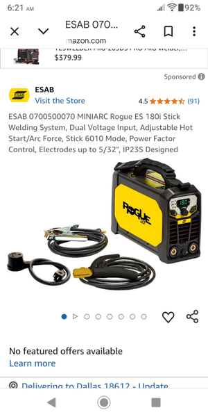

So just an update to this I decided to go with a 220volt esab 180i for the garage .
Everything I read and the reviews were really good and I think it'll be just what I need for my repair and hobby needs .
Thanks
Ernie

Not a bad choice @ all for a home owner thats not using it on a daily or semi daily / weekly basis
The main thing you want to look for when buying a "new" machine in my opinion is the duty cycle- and for 99.9999999% of homeowners - they dont need a machine with a high duty cycle. Did you happen to check out the weldmonger or even 6061.com & Pacific arc sites?- these guys offer good tested machines if your not super up to speed on welding.
