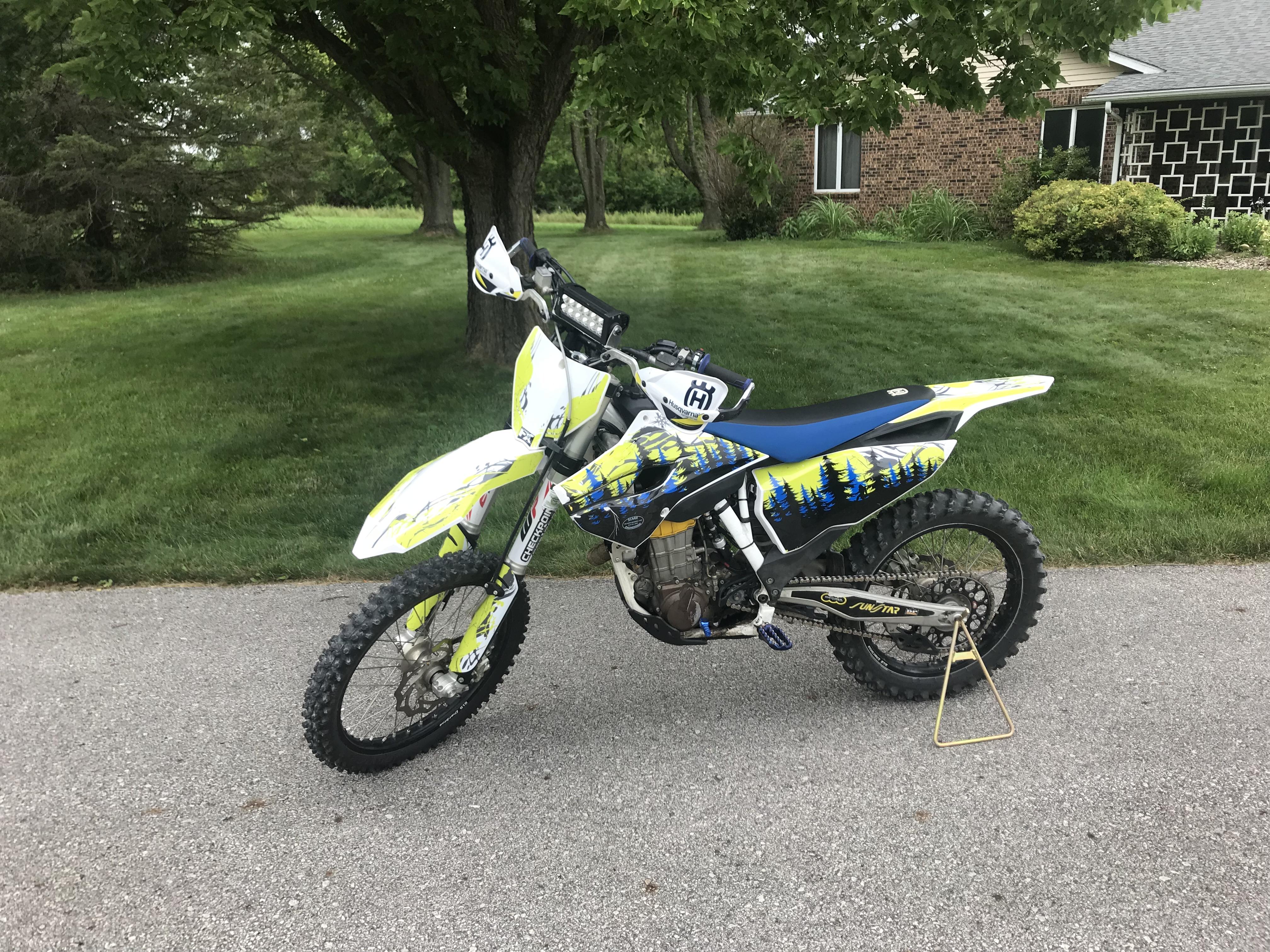

The r just made 59hp and 42lbs to the wheels, you should smoke me! But I did beat a 15 crf450 2 wheeler with a hi comp piston and exhaust, got him by four bike lengths, she is only 363cc View attachment 253040
That is a pretty flat curve, lots of usable power!
