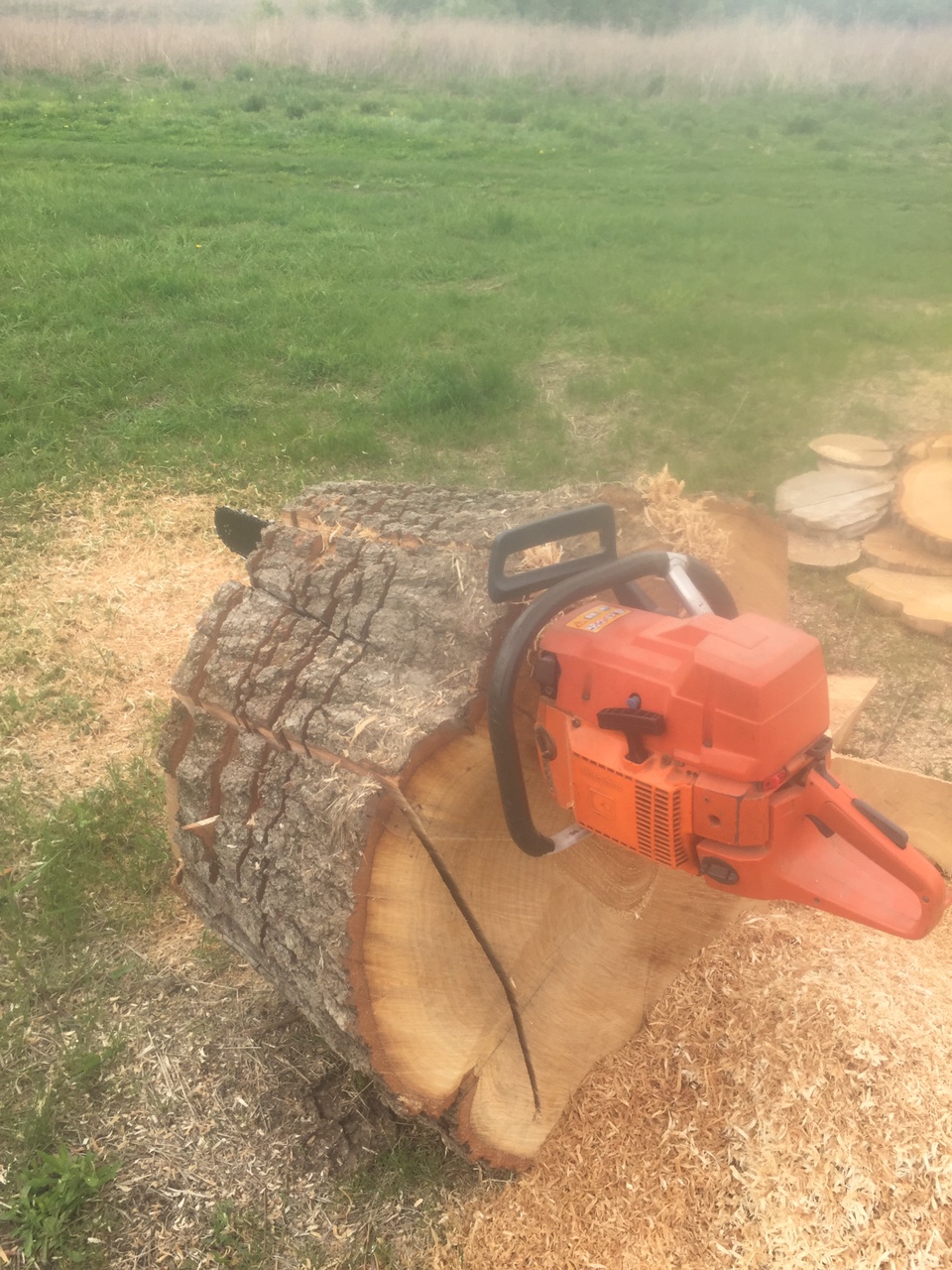

looking forward to joining the "288 mafia 4 life" this should be a fun week!View attachment 182331
The GOOD: Extremely low hour that seems to have spent the last 2 decades of its life on a shelf in a barn, high top w/ K&N, pressure and vacuum 100%, 2x rubber front AV and 4x spring AV in rear all in good condition. No chain rash, plastics intact, almost no wear on clutch, and the sprocket looks like it was barely used.
The BAD: Low 150psi, random bolt shoved in muffler flange that needs to be retapped and proper 'sert placed in there, wire insulation deteriorated to the point it is just falling off need to replace red/blue wires, PO used waste motor oil so the tank needs to be cleaned and the whole saw smells like burnt clutch friction material, missing muffler gasket, and scored piston. Cylinder is AOK and will be ported for extra giggles.
