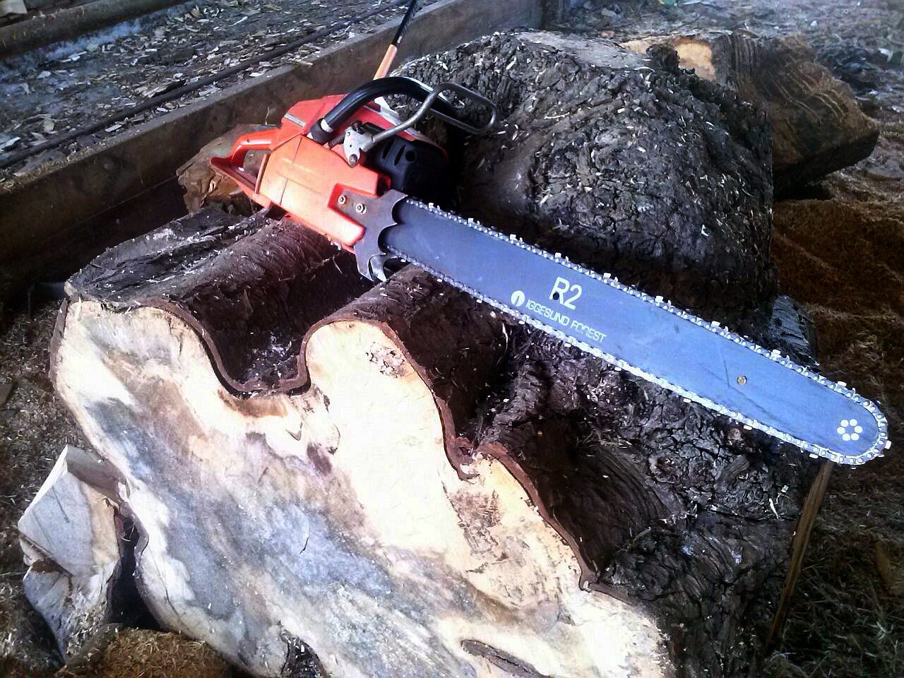

Beautiful work my friend. I know it's a Lite, but to me 288s look odd without the seventh mount.
@Onan18 send me a 7th mount and i'll be happy to dress her up just for ya! :rolleyes:
I'm going to test out a 385/90 and a 395 full wrap today and see which i can make fit better and likely go that route so i have the option of full wrap when needed.
