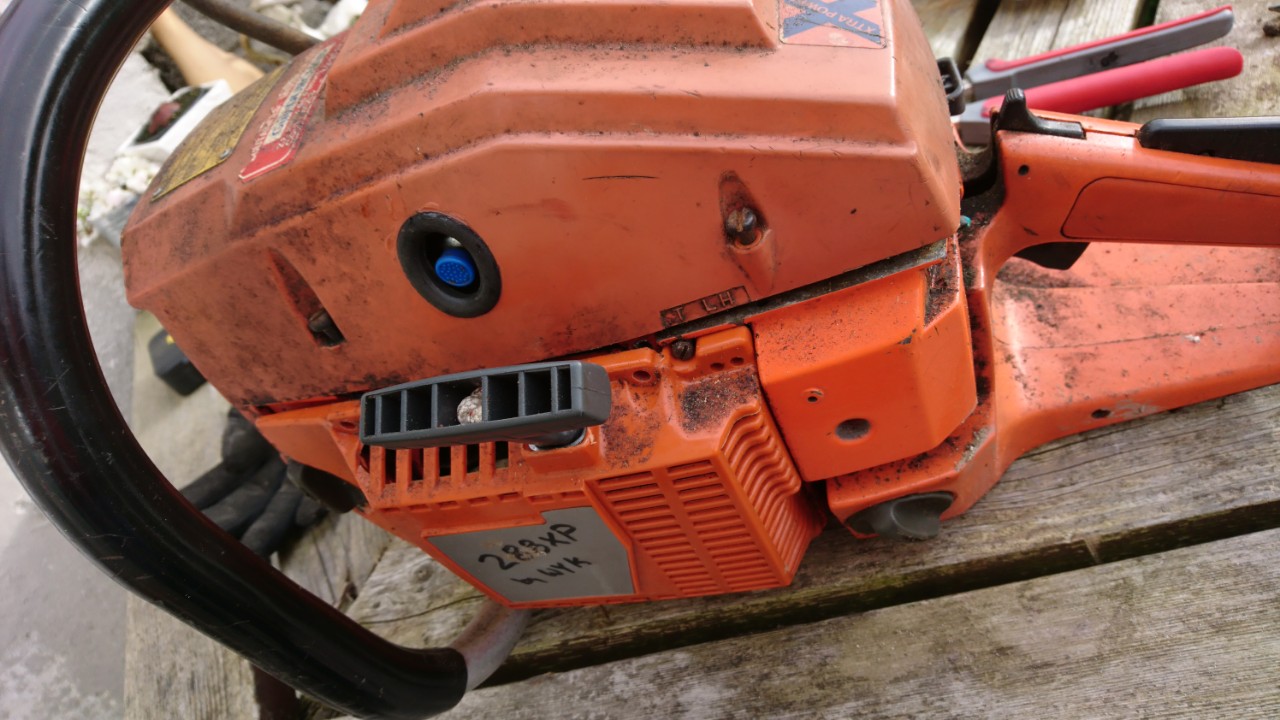

No one has a top cover in stock. But, that's OK. The thing about living in Ireland is you have to find a way to make stuff work. It's expensive bringing stuff in, and there's precious little about to make life easy. So I went and opened the hole up a touch more with a dremel so the crack might not grow larger in the future, grabbed a rubber grommet and some super glue and went to work:
The Trick in Stopping a Crack from migrating is to drill a stop hole, usually a 3/32" - 3/16" hole. The Bigger the better in high flex / Vibration area and after drilling the whole you can put RTV to somewhat hide it, find the Very farthest point in the crack, Center the drill bit With the Back side of the drill radius touching the crack and it Shouldn't migrate any farther after that, and for the top cover I'd probably Not go smaller than 1/8", I have No idea what that is in Non Imperial mm size, America
Bud
P.S. If possible, Glue, rivet, RTV, anything to the Backside to Distribute the Stress over a wider area and minimize stress / Flexing that caused the Crack in the first place. The More Surface area, The Better. And you can be Very Creative in backing material. Just make Sure that it can Handle the Environment of sed Material, for low heat environment I've even RTV'ed old jean material, aluminum sheat metal ( I would put a few holes in it towards the edges for extra hold ) even leather. The slow cure JB weld works well, if it adheres to the material, I would avoid Any 5-10-15 minute epoxy
( Low Adhesion)...
