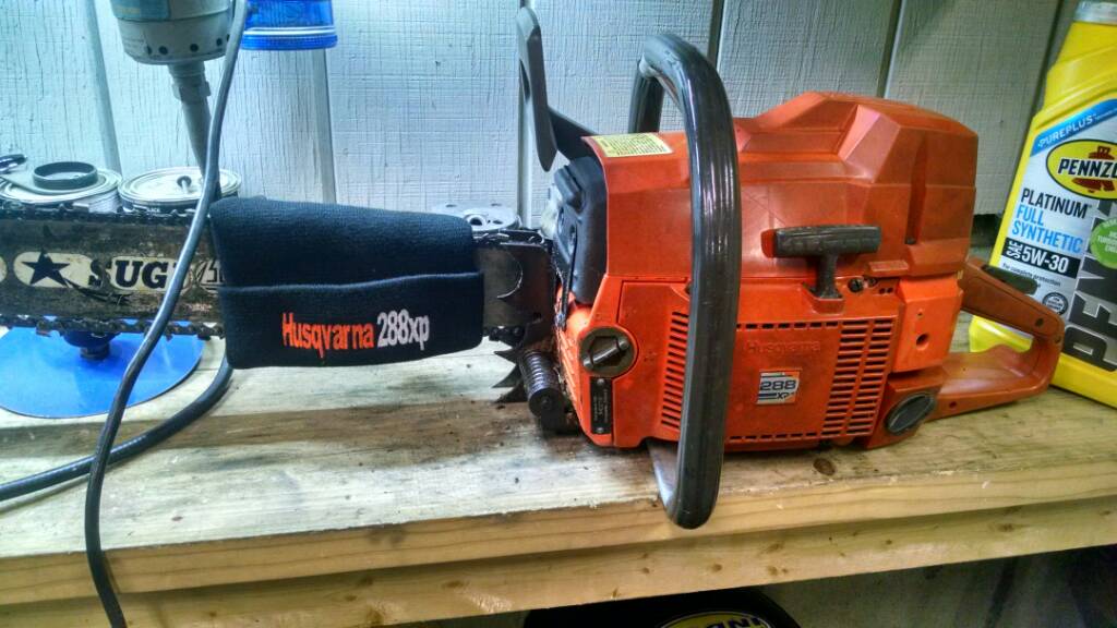

Glamour shot.
That's a damn good looking saw DJ. And the hat is cool too.
