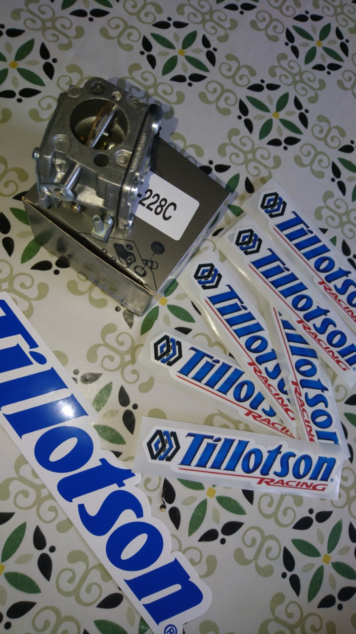

I sent some email to Tillotson down over in Tralee. Perhaps they still at least have a rebuild kit. This is provided I find the original carb...I also asked if they had an HS-228C laying about, but I think we know what our chances are there.

Well whatttaya know - first thing this morning they had a lad checking email:
Hello Wesley,
Thank you for your email.
The HS-228C is available and also the repair kit for that model RK-23HS is available.
The kit can be purchased on our website if you want to try that first.
Thanks,
Kind Regards,
Mr Shane O'Connell
Tillotson Limited,
Clash Industrial Estate | Tralee | Co. Kerry.
Tel +353 66 71 62506 | Fax +353 66 71 24503
www.tillotson.ie
