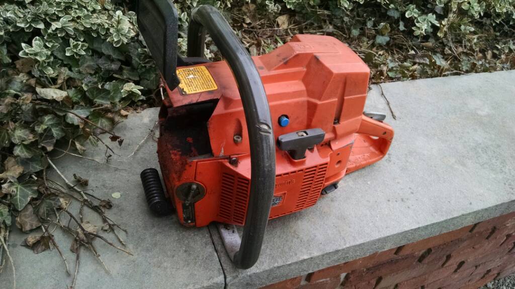

Picked this one up a week or so ago. Needs some love. Sucks that chunk is missing outta the top cover but I can work around it.

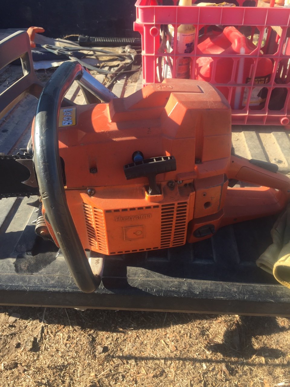

Picked up my first 288 today.
Starting to go through it. Looks to be some light scoring on the piston.
Tank has a JB weld fix. Going to tear it down and see how bad the damage it.
She’s a little rough. Needs a clutch cover with chain brake, air filter, piston and rings (hoping I can make the cylinder work) and I’m sure a few other things, probably seals and bearings (as long as the cases aren’t trashed from the JB weld)
Any pointers before I start?

I Like that Stay Cool Clutch Design !!!!
That Will Keep the Heat away from the Crank, Bearings & Seals !!! Hooskiy is Always Thinking of Better Ideas...

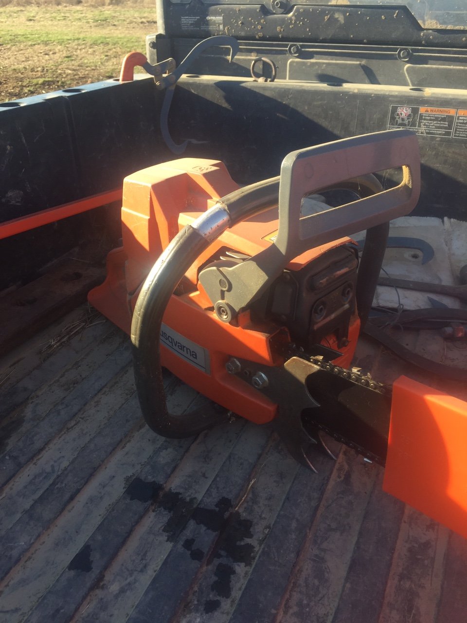

Well that was short lived.
Clutch side case has a large crack
I don’t think it can be salvaged.
Cylinder may be saved?
Piston has some carbon smearing but not much scoring.

The Trick in Stopping a Crack from migrating is to drill a stop hole, usually a 3/32" - 3/16" hole. The Bigger the better in high flex / Vibration area and after drilling the whole you can put RTV to somewhat hide it, find the Very farthest point in the crack, Center the drill bit With the Back side of the drill radius touching the crack and it Shouldn't migrate any farther after that, and for the top cover I'd probably Not go smaller than 1/8", I have No idea what that is in Non Imperial mm size, America
Bud
P.S. If possible, Glue, rivet, RTV, anything to the Backside to Distribute the Stress over a wider area and minimize stress / Flexing that caused the Crack in the first place. The More Surface area, The Better. And you can be Very Creative in backing material. Just make Sure that it can Handle the Environment of sed Material, for low heat environment I've even RTV'ed old jean material, aluminum sheat metal ( I would put a few holes in it towards the edges for extra hold ) even leather. The slow cure JB weld works well, if it adheres to the material, I would avoid Any 5-10-15 minute epoxy
( Low Adhesion)...
I just enlarged the hole a bit and placed a gasket in it. WHat happened is the bit grabbed and cracked it as I was drilling. So it made a rather irregular hole. It's OK now, tho. Cheers, bud!
