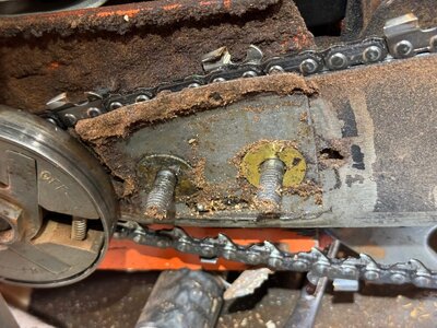

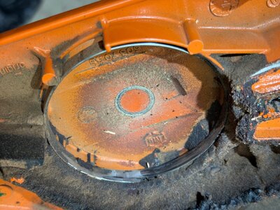

Hm, nother 288 just started doing this. Clutch nut stuck out past crank end seems same as other saw, bar thickness standard, clutch hub same as others. Swapped to one that was a few thou thinner and put an outer bar plate in the stack…
Think this will clean up?

I think I see the bar pads present, the clutch however appears to be out too far as in something is holding it back from going in all the way.
Ernie had an issue with this. Turned out to be an early model trying to use newer model parts. There are differences
ErnieG
7:25 AM
15345
Jan 12, 2021
871
1,602
Northeast PA
I had to grind that little bit off the drum that protrudes out past the clutch and it worked out .
I don't remember if it was a aftermarket drum or OEM but that may also play a part in this problem.
Oregon 28094X is the correct one your looking for .
