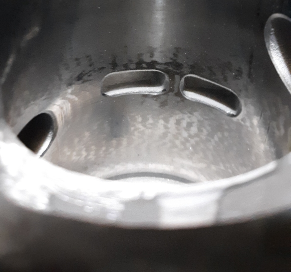

Got burned using a Hyway jug on an 028S. The original jug had some scoring, and the saw was a homeowner saw who only cut a few cords a year.
I cleaned up the band on the lathe, cut base for squish, widened exhaust, raised transfers and did my best to fix the horrendous intake port. Plating looked good, used the hyway piston.
Saw was run for 2 tanks and wasn’t making power. Found this:
4D607444-72EE-43BA-AAFC-902790C5A76C.jpeg AE9A3E6F-8FE9-471F-A371-F6427E433A7D.jpeg EAC3B1D3-D27B-4E7D-86D4-2187212FC54A.jpeg
Top of plating worn through, even using good oil. No piston damage.
Think I woulda learned by now. I put the jug and piston back where they belonged and used an oem P&C.

Well…
View attachment 332612 View attachment 332613 View attachment 332614
Do you think the bore is undersized up there? Like maybe they were honing the aluminum before plating and due to not being able to hone all the way through in a blind cylinder, it left that area small?
I see that being a good possibility. Binding up high.
Unrelated-NWP is the only AM jug I’ve seen worth a *s-word. The cheap cheap ones are laughably bad. Transfers in damn near ever AM cylinder are awful and are most important imo.
I bet it's oversized there. I've seen AM cylinders like this where the hone hasn't touched the last 3/4" of bore and its left as rough plating. Due to the nature of plating a blind bore the end of the anode deposits slower than the rest of the bore. So if the bath concentration is low, the bath time is too short or if the original bore was too large you'll get an unhoned bore near the squish band.
So it basically comes down to cheap manufacturing, with loose tolerances and a just ship it attitude.
