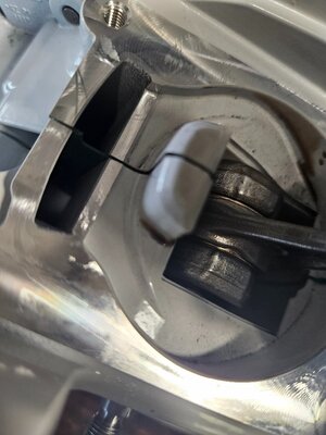

I have a 400C and its not a PITA to work on. I see the 400.1 one as basicly the same in that regregard
Look at my photo again and imagine how you would cut the base on a lathe. Than add asimetric chamber design and imagine cutting squish by hand like I do. It has nothing in common with old 400 believe me

Picture of the case where the transfer entrance sits please?

In regards to porting you are probably right. Im sure the pro's will figure it out.
