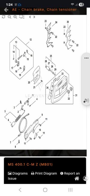

@ferris
I don't have a pdf of the ipl
This would be for the wider/west coast sprocket cover. Looks like the inner spike is what you would need. To make the outer 660 spike work right
el33t
12:34 AM
29908
Aug 28, 2024
277
691
Poland
@jmester
I found ur picture strange, because number 30 (1122 664 0506) is in outer dog in ur picture.
In the old ipl these number is for an inner dog.
Can u follow me and is this correct?
Indeed, it looks like there are probably interchanged part numbers. I guess 24 should be 30 and vice versa.

1122 664 0501
Bumper spike
Is the outside spike on the 500i wide cover
1122 664 0506
Bumper spike
Is the inside spike on the 500i
jmester
6:34 PM
1769
Aug 28, 2016
1,263
3,715
VIRGINIA
@ferris
I am following what you are saying. They must have it listed wrong. Looked through the other variants on the 400.1 they are all the same. I am thinking @el33t is correct
