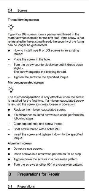

I thought most of the new stihl aluminum fasteners are torque to yield which means they are single use and should be replaced if disassembled. Page from 500i service manual.

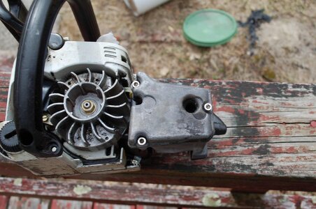

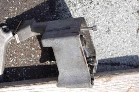

Mad Professor
6:51 AM
14251
Oct 21, 2020
552
2,431
Northeast USA
They built Stihl 500 as nice, as an 009........
Yep 009.
My 009 had cheap s/t screws in the muffler which failed, stripped out and muffler a rattle box......
SS Cap screws fix.
How many 500 be going 30 years from now? With aluminum screws.
009 muffler installed.jpg009 muffler inner case tapped for 5mm cap screw.jpg
