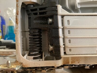

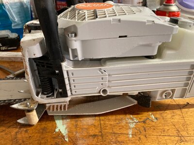

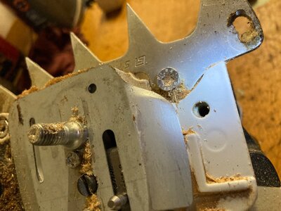

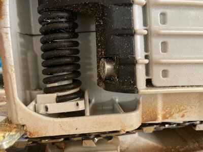

After sawing yesterday, I noticed that the AV system felt strange. It was loose in one direction. I then noticed that this white part was loose. See pictures. At first, I thought Stihl had forgotten something on my saw. I found the problem today. I've upgraded the saw to different dogs and roller chain catcher. I removed the old chain catcher and its screw in the process. But that screw is exactly what holds the white part on the other side.
