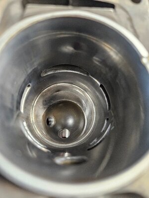

I ported one, have two more to do. I did cut the base and than use JB weld to reconstruct that extension back. Went couple of times in and out. Didn't find any real gains to be honest. it seems it does like higher exhaust.
Second one I will try only BGD and squish cut to see if it's worth all the extra work.

What do u guys think is the reason for the better gains compared to only opening up the original outlet?
Is it the bigger size or the reduced volume?

Doesn't the stock 400.1 muffler have an insert into the exhaust port?

My attention to the video was divided, that insert removed?

My attention to the video was divided. Was that insert removed?
No I think it’s fully stock back half with a flat plate bark box style replacement for front half of can that has the outlet on it. So it made the exhaust outlet huge but also reduced the can volume by 40-50% probably

Interesting. The larger outlet is to count for all the gains made, is my guess. Why not chop the insert, max out the exhaust port width and match the muffler to the port? <Serious question. I know just enough about porting to be dangerous
