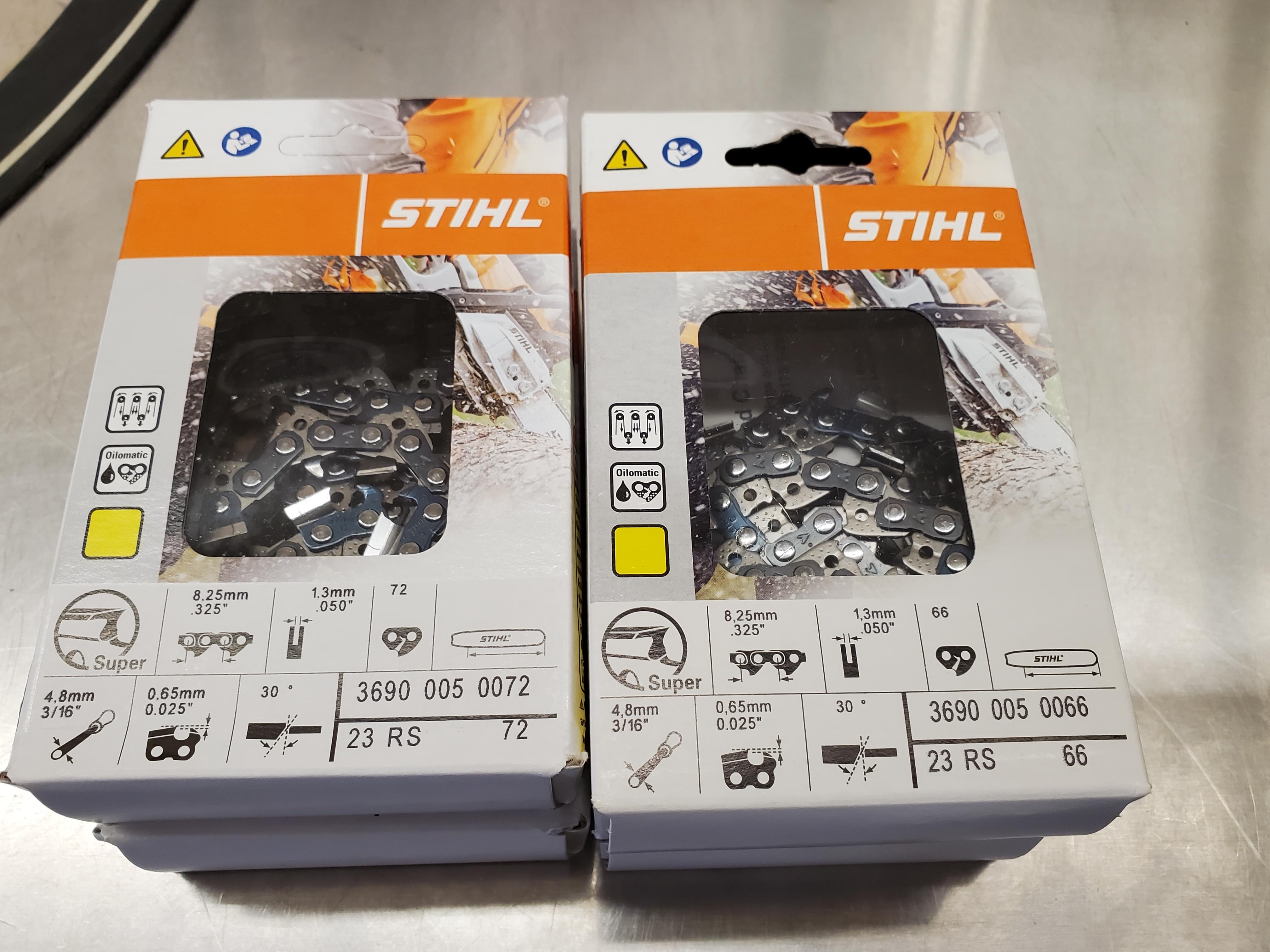

Just checked on Stihl's site and cant fine RSP. Got a link por favor?
Here's part numbers for the 66 and 72dl RSP chains.

Preciate it. Got a couple things to pick up at my dealer, will get them to get me a couple loops.
The above pics are 3/8s though right? Not .325?

The drive links threw me off. The only .325 I run is on a 20" bar, 81DL I think.
I was thinking 72 was for a 20" 3/8s bar and 66 for an 18" 3/8s.
Thanks for the info

The 72 is Husky 18" bar.

You said you only run 20"
For the guys running 16" I have been able to use .325 x .050 x 67 DL on both the Husky and Stihl. I have 8 pin rims on both.
I didn't have any luck with the Stihl running the 66 DL chain, which would be the correct count on a Husky. 66 was too short on the Stihl, even with a 7 pin...
