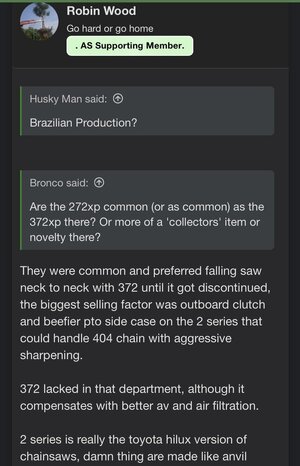

Husqvarna's answer to the 044 was the 272XP and it fell short. They tweaked the timing and nailed it with the OE 372XP.
That is interesting, I have an 046 and a 272 and they felt about the same to me when cutting, I actually prefer the 272, as it feels a little more balanced. I was taking both saws for firewood cutting until the 046 developed racing stripes on the piston due to an air leak. A lot of people I work with use the 372s, they really like them. I think most are OE with a coupe of x-torq mixed in.
046 may run more like a 272 than it does an 044.
