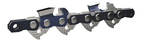

Pic from Stihl's site. Neat- must be the -3 version
  • .325˝ RSP chisel
  • .325˝ RSP3 lower kickback chisel
  • .325˝ RMP semi-chisel
  • .325˝ RMP3 lower kickback semi-chisel
.325" RS PRO
SAW CHAIN
Suitable for a variety of demanding jobs, such as felling, limbing, clearing young trees and firewood cutting. For chainsaws in the power rating ≈ 2.2 – 3.0kW. For use only in combination with a guide bar with a groove width of 1.3mm.
ORDER NUMBER
3690 000 00XX
Technical Data
Pitch
Drive link thickness File size Sharpening angle Depth gauge
.325" 1.3**mm/.050" 4.8mm
30°
0.65mm
I think what you want is 23RS Pro not RSP. I run RS Pro and it is very good chain IMO, they have taken material away from the rakers and opened up the gullet as well as possibly making the cutter taller. I think it is similar to 3/8 RSK but in .325.
