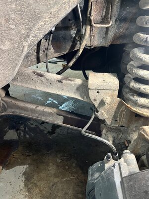

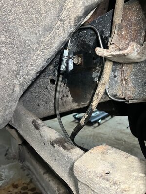

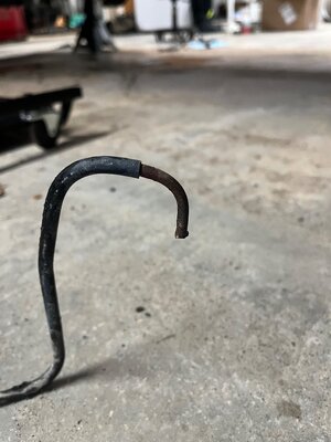

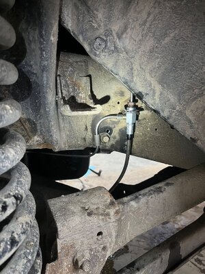

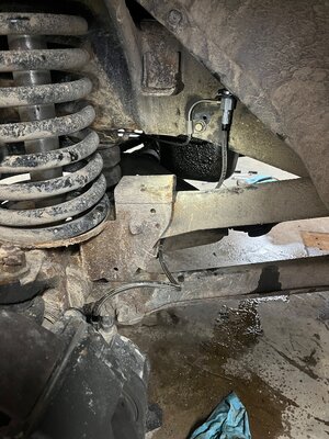

Also replaced the hard line that runs along the crossmember, under the engine, from drivers side to passenger side. While loosening the fitting on the passenger side, it twisted off from being stuck/rotted.. The new line was a pre-bent stainless steel piece, that I ordered as a kit about 6 years ago. I’ve just been replacing the lines as needed, instead of doing them all at once.

Here’s the link to the stainless brake line and hose kits:
This was one of the best investments I made for this pickup. They make a lot of kits, and are an asset to any vehicle you plan to keep for any length of time (especially in salt covered road country).
