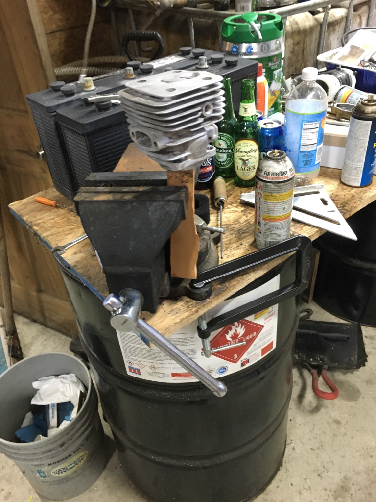

This cylinder had bad transfer, I was finishing cleaning that up and the plating peeled a little below the exhaust port. Do you think it's okay to run it? IMG_20170407_115007151.jpg

I'd use it too. What did you wind up doing to the jug?
What's the squish you arrived at?
I'd get a cylinder brake hone and hone the jug with some oil and the hone. Then wipe clean and do again with scotchbrite.
I've found that those rough sanding lines in the plating will tear up a piston skirt rather quickly.
Haven't done anything yet, parts should be arriving this week. I will degree the cylinder this week and post what I find and I'll go from there
