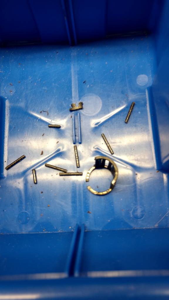

Yep. But only because that's all I had. It's getting replaced with oem when it comes back apart for porting. I don't see where changing out a known source of catastrophic failure, yet doesn't add to performance, should be a big deal.
Ya mean like this....
