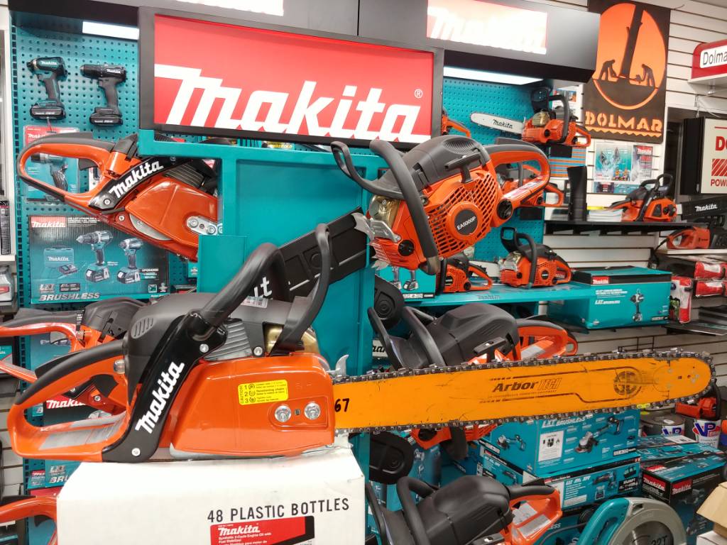

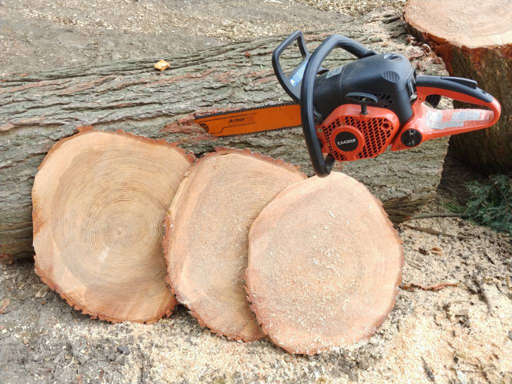

Got a guy that just bought another 4300 with this bar and chain setup.

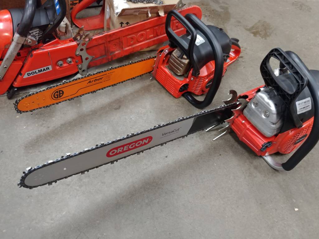

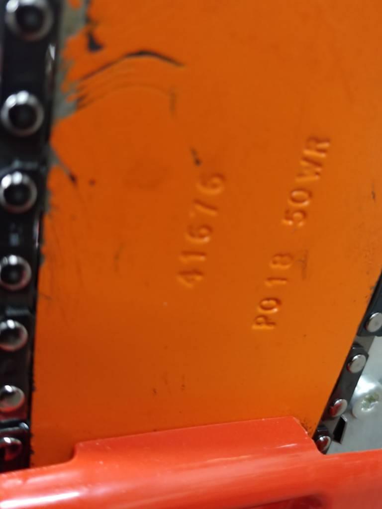

It was in the basement...

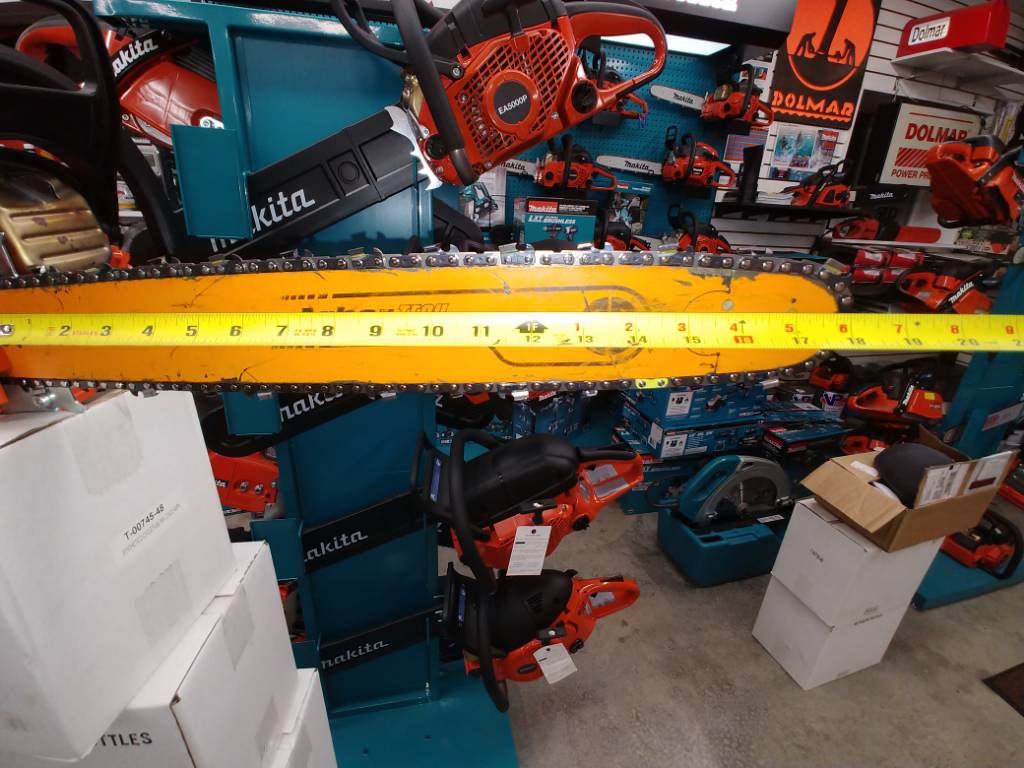

I setup two of these back in July for a photoshoot. One was on one of my saws and the other was on a customer's saw.
Couple days ago he wanted another setup just like it so I put that bar on a new saw.
It's a full 18" past the spike bar. Setup with 67 drivers of 63PS. Normal 18" bars this mount are 62 drivers.

How come this customer wants the full 18" bar set up on the 4300 Steve ?

Because with the stock Dolmar 16" bar you only get 14" of cut past spike bar. Others have shown that this saw can handle the 18". Wish there were more bar choice available for 421 with 3/8 lo pro.

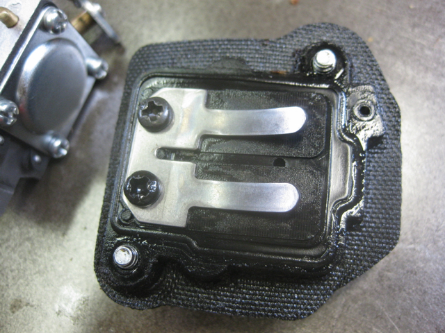

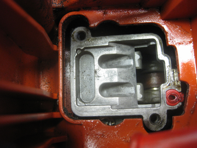

Does anyone have any info or maybe a repair manual for the Dolmar PS-3410TH tree saw?
Mine is giving me trouble, acting real weird, and I'm getting ready to rebuild the carb. But I notice that this saw has reed valves and I know almost nothing about reed valve engines. Do you do anything different when testing for vacuum/pressure leaks? Anything else I should look at?
Thanks in advance for any help.

Still looking for a repair manual, if anyone can help...or even more generalized "what to look at on reed valve chainsaw engines" information...
