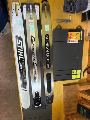

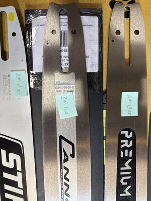

I will add: Tsumura on top is large Husqvarna mount while the Cannon and Stihl are 3003. Weight by digital scale and all are 28”. 3003 are 91DL and the Husky is a 92DL specified but I'm using a 91DL chain on it also. All are 3/8" by .050" . All are good, happy with these and Sugi. Husqvarna large mount are on ported 372XP's for what ever it is worthimage.jpg
