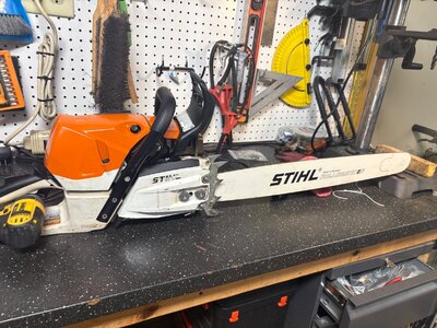

Just finished up this ms462 for a tree service friend. He ran it over with their trailer.
New handlebar, brake, cylinder cover. Some things bent back into place such as the muffler, felling spike, chain catcher. Repaired the rear AV mount on the fuel tank with some JB.
