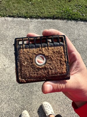

Gave a coworkers Echo 3450 a tune up.
-new bulb
-new lines
-cleaned air filter
-new plug
-low jet adjustment
-fresh mix
If you wipe your ass after pooping, why not clean your filter after cutting
Ive bought a few parts saws online, and I always have the thought, "If this thing wasn't so got-dandruff filthy, it would still be running!"

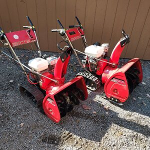

Older Honda tracked snowblowers have sparked my interest recently and naturally one wasn't enough. Bought the 80 and then the 55 showed up for sale online shortly after so it found its way here. Tore both machines to pieces and cleaned everything, replaced all the bearings, bushings, belts, oils, shear pins and greased everything. Sprayed a coat of fluid film in the rust prone areas. Got them all wrapped up today and ready to relocate snow. These things are stupid easy to work on.

I gotta have one! What's a fixer upper go for?
The 80 was $250 and the 55 was $100. These machines were produced in the 80's to the early 90's and some parts are nla. However, some of the wear parts like the friction disk, honda still produces and stocks for $55. Many of the wear parts like bearings, bushings, belts, etc are everyday common sizes that are inexpensive. Ebay still has many nla used parts available and these machines are still in abundance all across the north. I plan to acquire one more of each over time just for spare parts.

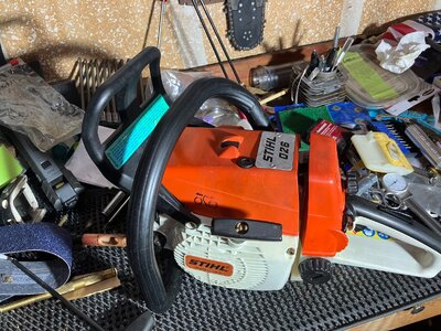

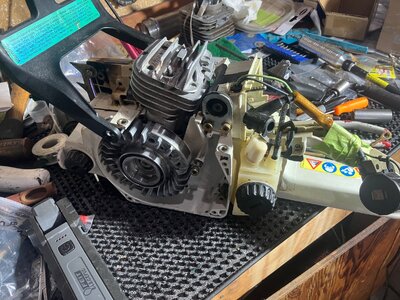

What little I ran this one before tearing it down I really liked it. Just finished porting it, so should like it even more.
