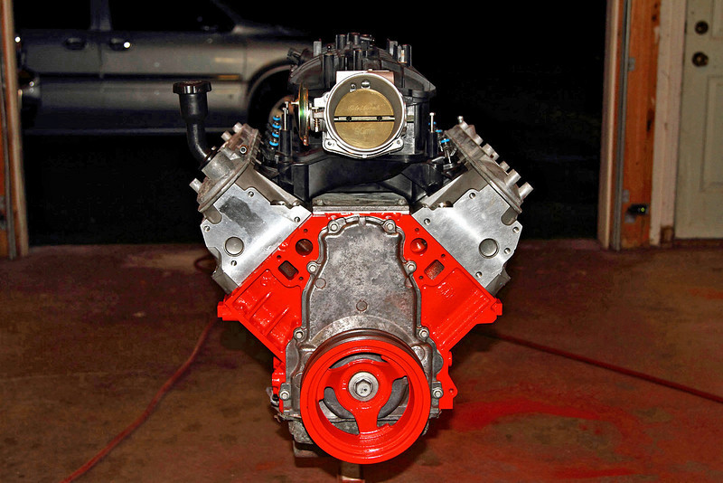

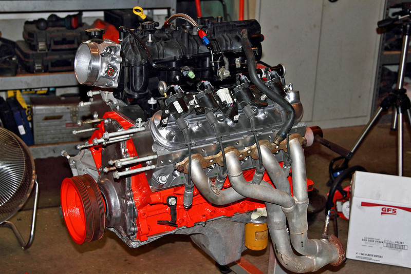

2001 GMC, w/built 6.0L and 4:30 gears.
How much horsepower and torque for that 6.0 LS?
8:36 AM
I've not had it on a dyno, but it should be around 500 at the crank.
